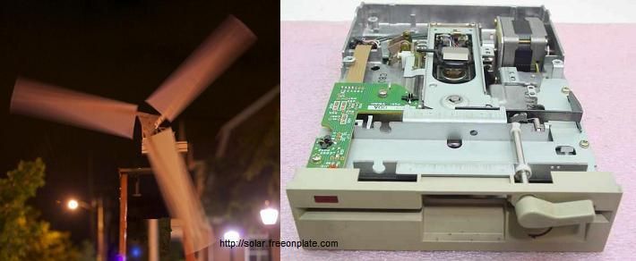

Step 1: 5.25" Floppy Drive Windmill Construction
First, we have opened an old generation PC286 and removed 5.25 inch floppy drive unit. After dismantling the floppy drive unit, we have carefully removed stepper motor.
We have drilled two holes with stationary drill on the shaft and directly attached the turbine (propeller).
Next, we prepared electronics which has a task to rectify alternate current and to filter and stabilize the voltage at 5 volts. You can solder all electronic components directly. Now we have to make the remaining mechanical parts for the wind generator. We need to prepare a bracket and a turbine (propeller). Bracket can be made of aluminum tube diameter 3-4mm, and generator (stepper motor) is most easily fastened directly to the bracket using clamps. You can easily create a three-bladed propeller using the meter, pen and scissors for cutting sheet metal. You will need a sheet metal panel 0.8x0.8m, 0.5mm thick.
