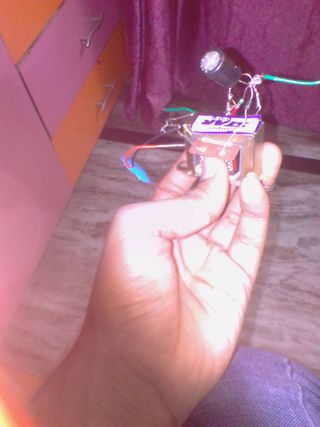

This amazing little shocker is very tiny and can be hidden almost anywhere and give someone a surprise shock! It can operated by almost any 1.5v batteries!
So, on this instructable, I will show you how to make shockers that is smaller than a penny!
However, the biggest disadvantage of this shocker is, it is very hard to build, but it may be easy for experienced soldering iron user (like me) to build the shocker...

Solder the transistor's base to the pin 4 of the transformer and solder the transistor's collector to the pin 1 of the transformer.
Again don't forget what I said... (Kind of)
Be very careful when soldering the transistor on the shocker, they are very heat sensitive, so solder it on quickly otherwise the transistor will burn out without showing any signs of being dead. Using the dead transistor on the shocker will lead you to many problems, some people thinks this instructable is a lie, just because they burnt out the transistor without knowing it...
Step 6: Hardest Part Ever... Step 2
Solder one lead of the 220 ohm resistor to the pin 2 of the transformer and solder the resistor's other lead to the pin 3 of the transformer.
Step 7: Hardest Part Ever... Step 3
Solder the cathode lead of the diode to the pin 5 of the transformer.
Step 8: Hardest Part Ever... Step 4
Solder one lead of the film capacitor to the anode of the diode and solder the other lead of the capacitor to the pin 2 of the transformer.
You might need to make one of the capacitor's leads longer with some wire to reach to the pin 2 of the transformer.
Step 9: Hardest Part Ever... Step 5
Okay, you are almost there!
Solder the 0v of the battery wire to the emitter of the transistor, solder the positive voltage of the battery wire to the pin 2 of the transformer, and solder the high voltage output wire to the cathode of the diode and the capacitor.
Step 10: Hardest Part Ever...DONE!!!
DONE!!! You did it! You had completed the world's smallest electronic shocker!

I made a shocker with an AA battery, it is very small - it can be well hidden in my hand.
I also built a shocker into a dark blue battery pack, and it packs a pretty powerful punch. I then gave it to one of my friends for him to use for halloween - but then, I later found out he trashed it for no reason... :-(
I modified a orange flash light with a hidden shocker inside! But it is not very effective...
