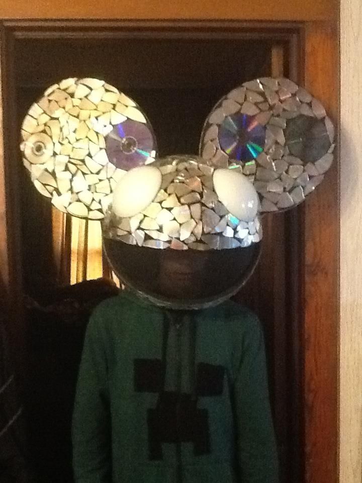

Just made mine in time for Halloween. Brought it to school and everyone loved it :) Thank you so much!
Reply 9 years ago on Introduction
Awesome! Thank you for sharing!!
