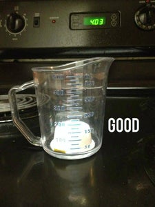

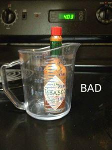

Step 1: Check That the Object Fits in the Measuring Cup
To calculate the volume of an object it must be able to fit in the measuring cup and be completely submerged if the measuring cup was filled with water.

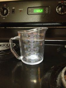

Step 2: ​Place the Object in the Cup

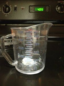

Step 3: Fill the Cup With Just Enough Water to Completely Cover the Object
Note: The amount of water used here is independent of the volume of the object. Just be sure the final water level in the measuring cup does not exceed the dimensions of the measuring cup.

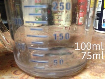

Step 4: Make a Measurement
Draw a line on the outside of the measuring cup with the dark marker at the height of the water in the cup. The line should be drawn on the milliliter side of the measuring cup.

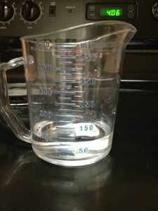

Step 5: Remove the Object and Make Another Measurement
Remove the object and draw another dark line on the measuring cup at the height of the new water line. Make sure this line is below the first line on the milliliter side of the measuring cup. Pour the water down the sink when done; it will make the lines easier to see.
Step 6: Record the Volume at Each Line
Now, get the paper and pencil or pen. Record the volume at the top dark line. Make sure the volume you are recording is in milliliters. If the dark line isn't at a clear line on the measuring cup, estimate the value to the best of your ability. Then, repeat for the bottom line.
Step 7: Subtract the Lower Number From the Higher Number to Find the Volume
Now that you have two values for the volume in milliliters, subtract the lower number from the higher number. This difference is the volume of the object in milliliters.
To convert to a more useful quantity, note that 1 milliliter = 1 cubic centimeter. You now know the volume of your object in cubic centimeters!
