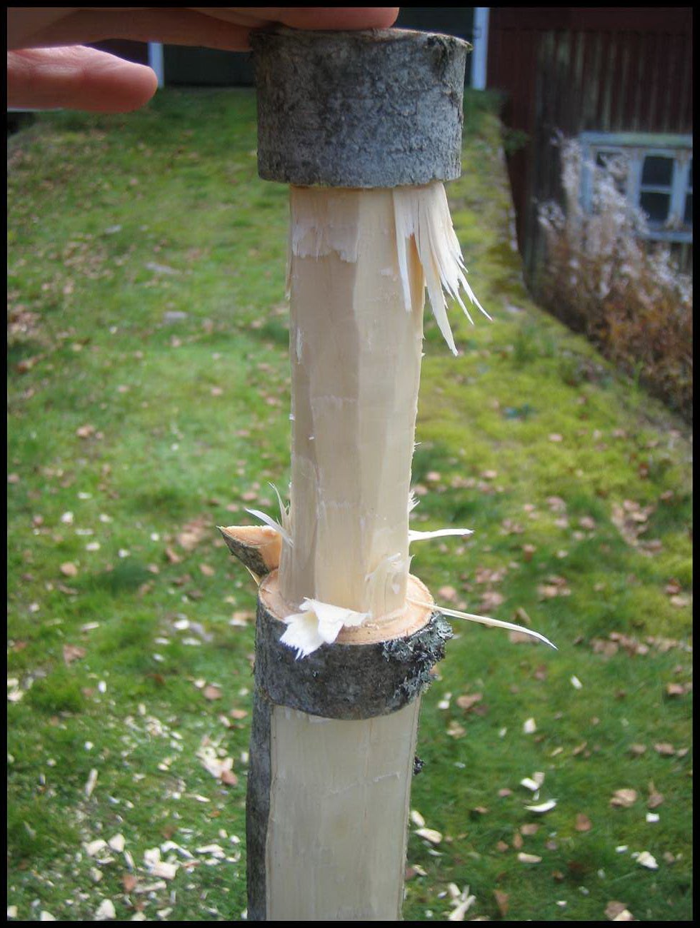

Step 3: The Rough Carving
I use my axe for most of the shaping. You can carve all the steps where I use the saw with the axe. But it is much more easy to do it with the saw. That way your sure that the cuts are straight.
Step 4: The Fine Carving
When the sword have the rough shape I use the knife to finish the carving.
