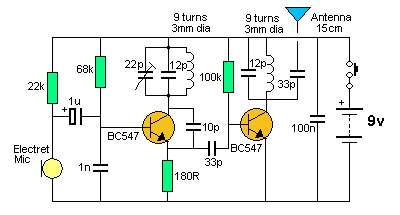

Step 5: Put It All Together
Now, simply wire the components up as shown in the schematic.
Note - the rectangle with the T on it is the transformer,
the middle symbol is the diode
and the symbol on the right is the capacitor.
You can easily add in switches,potentiometers, fans and heat sinks anywhere in the circuit.
Note - switching the direction of the diode will switch the polarity of the DC output.
