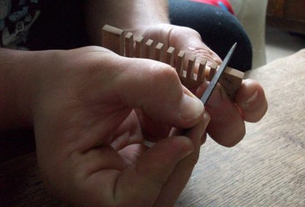

Step 3: The Comb.
The comb can't be cleaned as easily as the metal parts. The wooden comb will soak up and fluid that touches it. This is a major problem when playing a wooden comb harmonica. The tines swell with saliva and can prevent the harmonica from playing properly. They may not return to their original size for some time, if ever! You can see this effect on the intro pic. Don't worry we will fix this so it doesn't happen anymore. If you have a plastic comb then you can use alcohol but it will strip off anything thats printed on it and may affect the plastic itself if you leave it a long time. You can just use soap and hot water and give a decent wash. A good antibacterial soap may help. Skip to the next step.

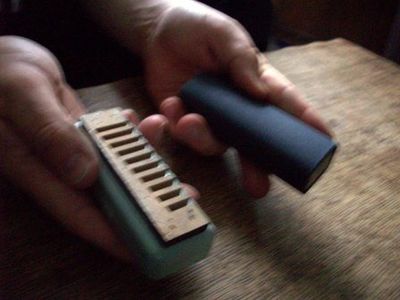

1. Using a piece of double sided tape, attach the comb to a block. Use a second block or a perfectly flat surface with sandpaper and sand the comb flat. You must make sure that the faces of the comb are as flat and even as possible. Check often that it is sanding correctly. You will see lots of saw marks from when it was made, you should try to get rid of most of these. A flatter comb gives a better union between the comb and the plate. When you have finished both sides and you are happy that they are flat and the comb is even, then you move on to the edge. If you want to keep the original finish then just give the comb a wipe over to remove dirt and sawdust. If like me, you want a different look then sand off the original varnish back to bare wood. Be careful of the tines as they can snap pretty easily (especially with old harmonicas). Don't go too mad, we don't want the comb to be too small for the plates.
2. Use a file or sandpaper to remove any dirt from the inside of each slot and make sure they too are nicely flat. Again, be careful of the tines as they can snap. You can glue them back on sometimes but not always.
There are a few websites where you can buy replacement combs or you could make one yourself. Just copy the dimensions. You will have to ditch the nails in this case and convert it to screws. This is something I will show you in another Instructable but it isn't hard.
File the corners of the tines very lightly so that the tine is more rounded at the end, this makes it more comfortable to play.
3. Now we will seal the comb and prevent it from swelling ever again! I use a mixture of 50/50 vaseline and beeswax. Melt them together, be careful they can be volatile. Use a bowl over a pan of simmering water. Once made, put it in a suitable container. You need enough depth to immerse the comb(see pic). Put it in and give it 5 seconds or so, any longer and it will soak up to much wax and swell. The wax will cool and dry quickly on the comb. Use your pocket knife to gently scrape the excess wax off the surfaces. Again, not to hard or you'll damage the comb. Polish the comb with a suitable cloth and you should be left with a really nice looking piece of wood.
