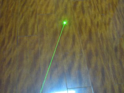

Step 6: Put the Laser Back Together and Test the Beam
Assemble the laser and test the beam.
it the lens was just dirty and not damaged, the beam and beam point should now be very clean and have good quality. If the laser still has a problem, the lens is probably damaged.
