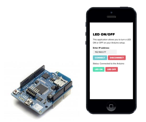

Introduction: How to Connect Your Arduino BLE Shield to a Custom IOS/Android Application Developed in HTML5 and JavaScript.
This instructable shows you how to build a mobile application that communicates with your Bluetooth Low Energy (BLE) shield. In this tutorial I have used a BLE shield from RedBearLab, but this example should be easy to rebuild to work with any other BLE shield. The mobile application will be developed using nothing but web technologies such as HTML5 and JavaScript. This is made possible by using the popular open source framework Cordova and a development environment called Evothings Studio, which is also open source. You don’t need xCode or Android SDK to follow this instructable. Let’s get started!

Step 6: Connect to the BLE Shield
If everything worked as it is supposed to you should now have the application pictured above loaded on your smartphone. When you press the Connect button in the application the phone will begin to look for BLE enabled devices nearby. When it detects one that is named “ble_led” it will try to connect to that and change the status of the application. Once connected you can turn on and off the LED using the buttons.Start tinkering!
