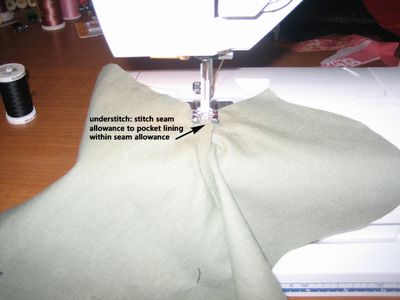

Step 4: Understitch
Use straight stitch to "understitch" seam allowance to pocket lining. This ensures that stitchin will roll toward pocket inside and pocket lining will stay inside the pocket.
