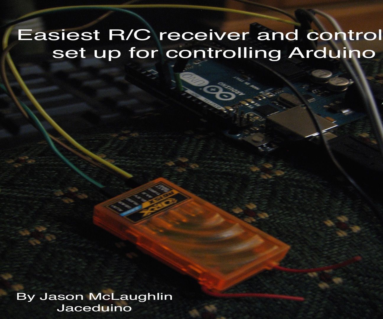

In this tutorial I will be showing you how to control your Arduino with a RC receiver and transmitter. This is a very easy set up and only take about 10 minutes depending on how many things you are controlling. In this tutorial when the rudder stick is set left or right it will make the servo sweep (100 degrees to 0 degrees and back) but you could make it do more then just that.

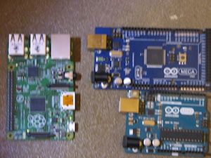

Arduino Uno or Mega

Step 2: Wiring
Ok you need to plug a wire from pin 7 to ch3 (and then if you want to add more channels you just need to plug in more pins) on the receiver at the top for the information line. Then plug positive which is the middle one to 5v on Arduino and then GND to GND.
The servo for this example is connected to pin 9 so hook it in and then GND to GND and vcc to 3.3v just for now or you can plug it into a separate battery pack.
Thats all the wiring for this tutorial
