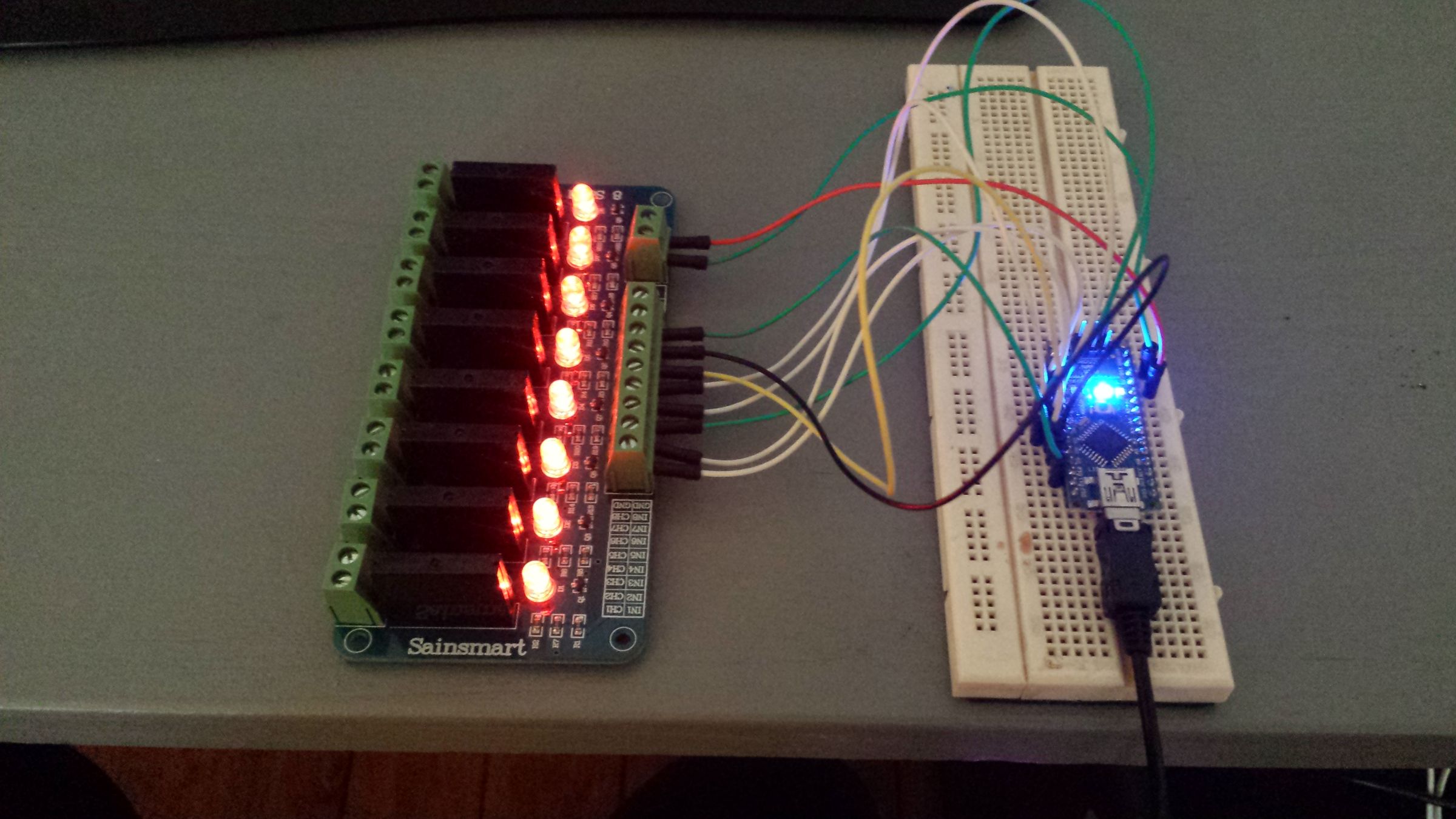

Just download the Arudino IDE, I am using version 1.5.4, then open the attached code in the IDE, verify and upload. Make sure to select the Nano board from the list of boards (Tools > board), also the correct COM port where the Nano is connected (Tools > port)
If all goes ok, test all outputs, now simply by connecting a 220 Ohm resistor to a Led, where the negative led leg goes to Arduino Grd pin while the positive goes to the output being tested. Alternatively, you can connect the SainSmart 8 SSR board to the Nano for a quick end-to-end test, follow the general design in step 1, you can use jumper wires to make your life easier in connecting the Nano to the SainSmart.
Open the Arduino IDE serial monitor (Tools> Serial monitor), make sure the selected baud rate is 9600, then type a command from the table, and check if you get corresponding results as expected. Pretty straight forward, no? :)

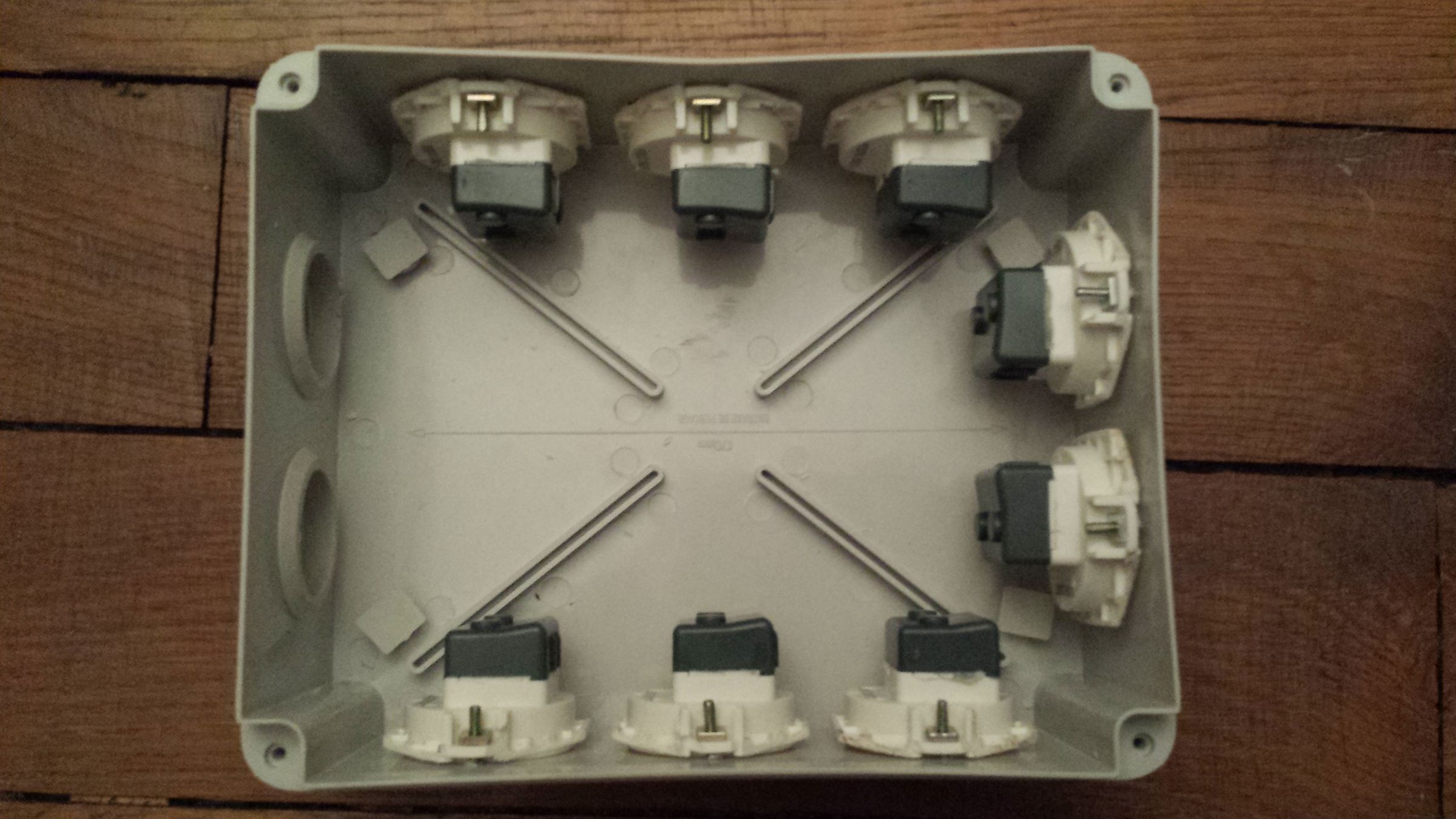

Box and sockets
Build any box that suites your needs, basically this is where you need to put all the electronics and isolate the 220 VAC away from hands. In my case and since the warning lights I got use AC adapters, so I got a standard 10-port electric box, in addition to 8 electrical sockets, then fixed the sockets at each port.

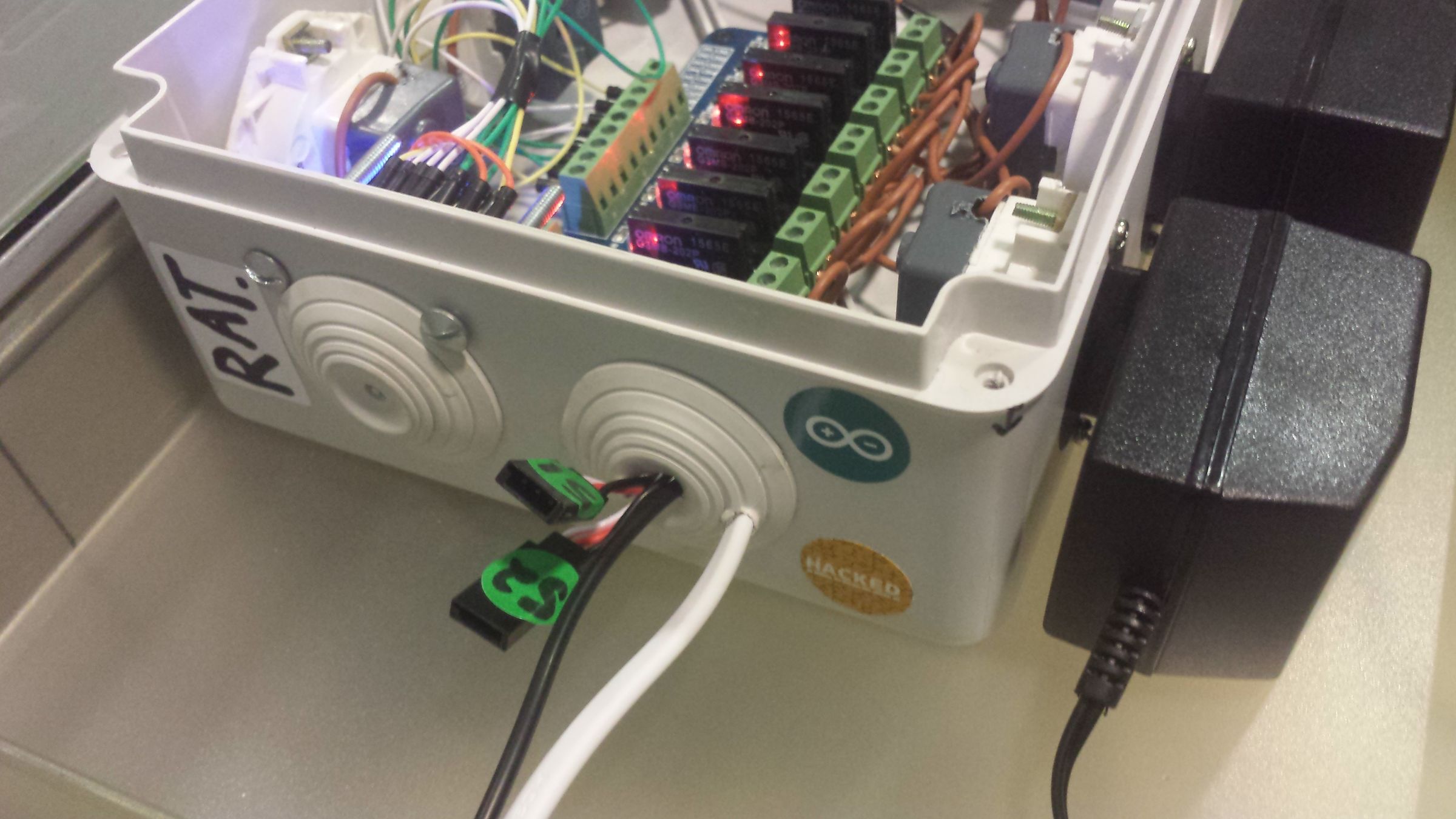

Arduino and other cables
I fixed the Arduino Nano on the side of box and connected it to the SSR board as per the design in Step 1, then ran the USB and Servo cables out of the box, then connected 2 of the warning lights to ports 1 & 2 to test:
The servos, power and USB cables:
