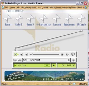

Step 2: Capture the Audio Streaming URL
When you play the streaming, the Real Player starts in a new browser window (Picture 1).
Right click on the Real Player window, just out of the player bar and select "View page info" (Picture 2). A new windows pops up with the information about the audio streaming (Picture 3).
Look for the "Address" URL, it should appear like the following:
http://www.radio***.it/player/player.cfm?Q_CANALE='''http://www.radio.***//radio*/****/***/file_name.ram'''
This URL is composed of two parts, each one beginning with "http".
The link to the source audio file is the second part of the URL, starting from the second http://www (Picture 3). Copy this part of the URL.

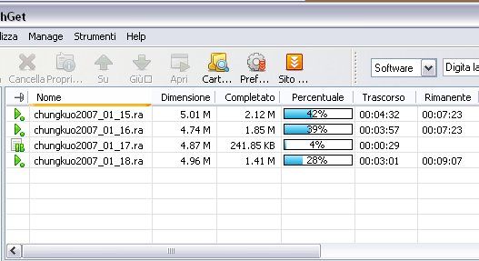

Step 3: Method One. Download the Source Audio File With Flashget
Start Flashget and create a new download by clicking on the large "+" button on the menu bar (Picture 1).
As a new window appears, paste the URL copied from the Real player in the URL line (Picture 2). Usually the copied URL is automatically pasted in this line from the clipboard. Check the destination folder where the destination files will be saved. The default is C:\downloads\. Confirm to start the download.
Multiple downloads can be started in each session. The downloads are listed in Flashget main window and their progressing is shown together with the estimated time (Picture 3). Each download can be stopped or paused to be recovered later.
After the download is complete you will get RealAudio Files with .ra extension. These files can be played on any computer with Real Player or other players that support this codec.
