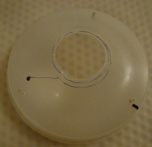

I started with the dismantling of the lamp to make some measurements for how much space I have in the lamp.

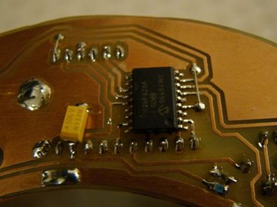

Step 3: Make the PCB
I use EagleCad for all my projects that needs a PCB.
The make the PCB with your favorite method, I use the toner transfer technique and Hydrochloric Acid + Hydrogen peroxide to etch the PCB.

Step 5: Start to Populate the PCB and Heat Sink
Start to populate the PCB with all the SMD components and visual inspect all your soldering. After that is complete, mount the PCB on the heat sink and mount the LEDs and all the hole mounted components.
