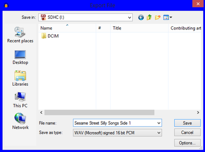

Let the first side of the tape play all the way through without stopping. (First image) You'll then need to export the audio to a file. Click "File" in Audacity, and in the menu that comes up from there, click "Export". (Second image)
The window seen in the third image will appear. Select your audio file format from the menu at the bottom, give the file a name, and save it somewhere. You don't need to bother with the "Album name/Title/Artist name/etc." window that pops up, so just click OK.
