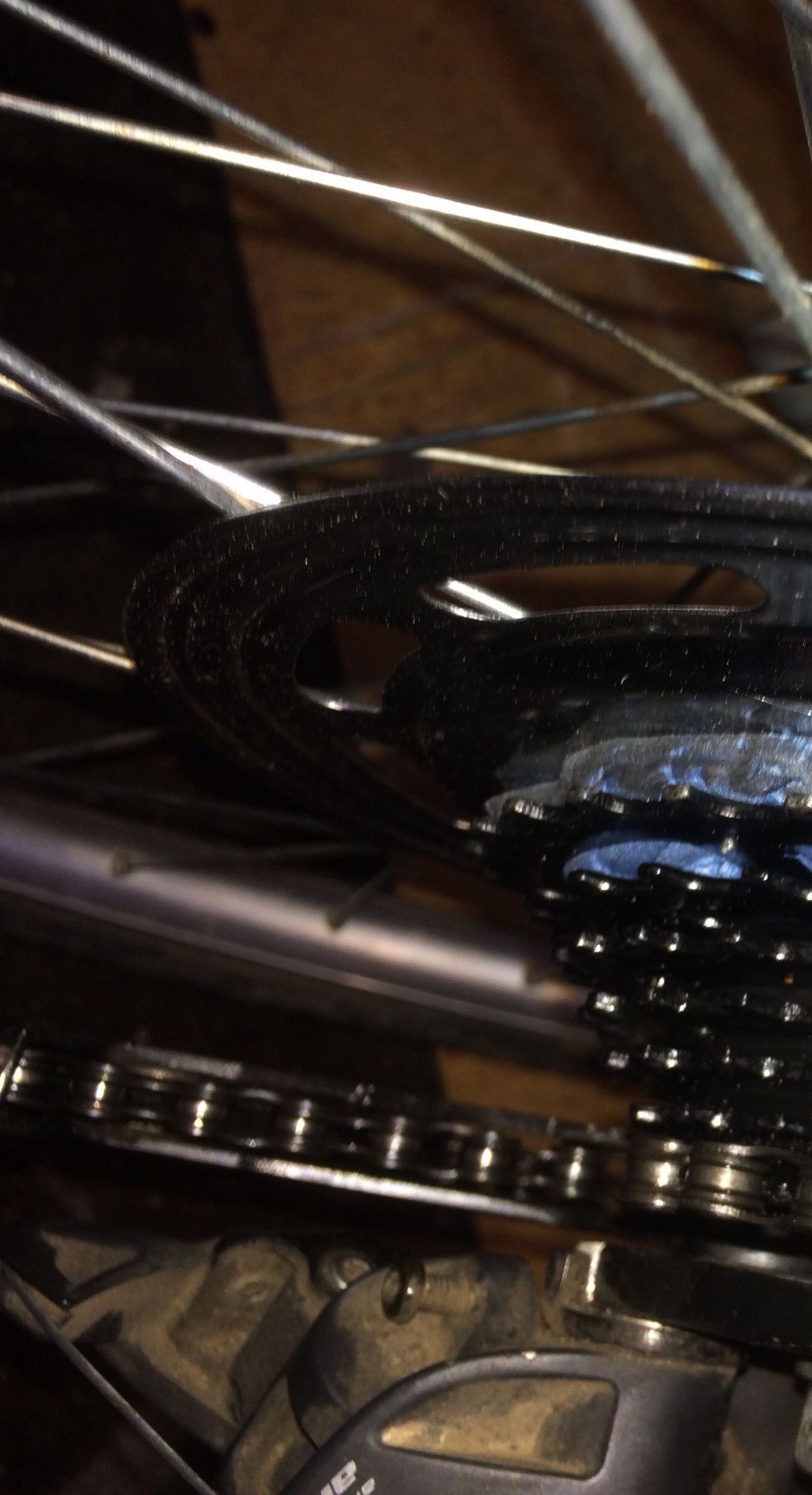

Step 1: Test Fit Your Components
You need to build the bicycle up so you can ride it, including shortening the chain as much as practical, and testing chain alignment. The bicycle should function without a tensioner, but you may have some "chain slap" or slack. This device will just take up that slack including chain wear, and prevent chain derailment over rough terrain.

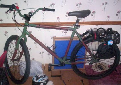

Update. This bike is still working great, and has been converted to a motor bicycle with a Dax Friction Drive kit.
www.thatsdax.com
www.motorbicycling.com
It is crucial that the wheel stays located in the same exact spot, and is secure at high speeds (20-30mph). This design has allowed a very solidly done steel multispeed bike to be made into a commuter bicycle with one gear to take-off or assist the motor.
