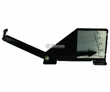

As you might notice on the video they only show you measuring the side with the mower chute. This is no accident as the other side is almost impossible to read a ruler on due to the fact that the deck obstructs your view. The current product for this purpose is a deck leveling gauge. This is the product I looked into as to the feasibility of producing my leveling gauge.

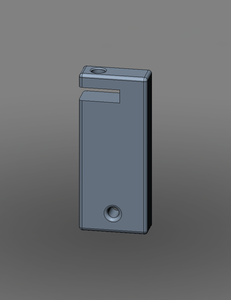

This gauge works by allowing you to use a line level directly parallel to the blades. By doing this you can see in real time without having to measure each blade how much adjusting still needs to be done. Once I find out what modifications I need to make to improve upon this design I plan on making another setup to allow me to do the deck pitch at the same time(deck pitch is the the front to back angle)
The gauge works as follows.
You clip the unit onto the outer edge of the outside blades on your deck.
You then run a line level tightly between the gauges with the level close to the side you are adjusting.
While adjusting the deck you can see in real time how close you are and how far you still need to go.

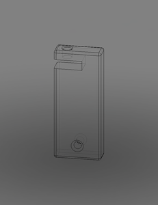

This is a prototyping instructible so the design is not yet finalized it will be after I get to test the product a little and make some improvements using a 3d printer that I will hopefully acquire sometime) But here are some of the problems I have to overcome before production.
1. Accuracy of production. I could not use conventional tools to produce this as I am wanting to improve the quality of job done as well as speed I need perfection in my production method.
2. Cost of production. I need to keep the cost down to sell them as the current gauges cost less then $20 each. Although the time saved in a production shop would more then pay for the tool I wanted a competitive pricing on what I produce.
