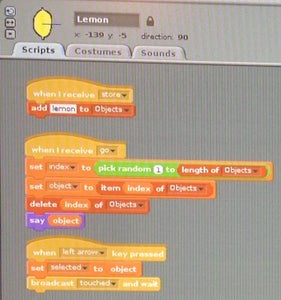

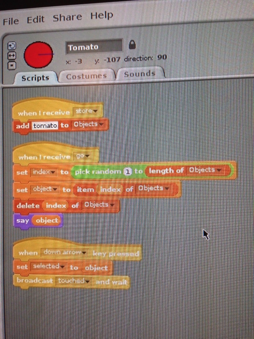

Select the first object (lemon) from the Stage. Create two variables for it, both "for this sprite only", call them "index" and "object". Drag the blocks into the script area as shown to configure the object.
- When "store" is received, add myself to the "Objects" list
- When "go" is received, pick a random number between 1 and the number of items in Objects and call it "index"; store the object at index "index" in the Objects list to the variable "object"; and then remove that object from the list; finally say which object I picked
- When the left arrow key is pressed, set the global variable "selected" to the object that I picked above; then broadcast that an object was touched

With the first object (lemon) selected, drag each of the chains in turn onto each of the other objects in the stage. This will copy over the configuration. Once this has been done (dragging 3 blocks for each of the 3 objects -> 9 drags) select the second object and tweak what's added to the Objects list (e.g. change "lemon" to "tomato") and which key triggers this object to be selected (e.g. change "left arrow" to "down arrow"); then repeat for the other two objects.
