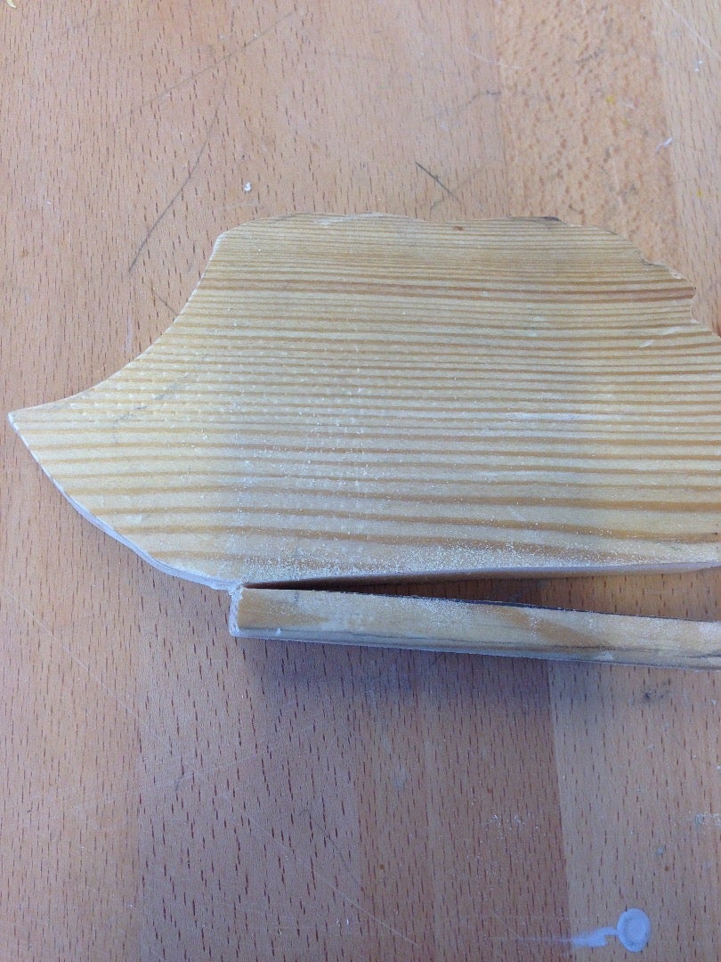

Also note that on the bottom of the toy a small piece , about 1 cm, needs to be cut off because that is where the wheels will be at the end.

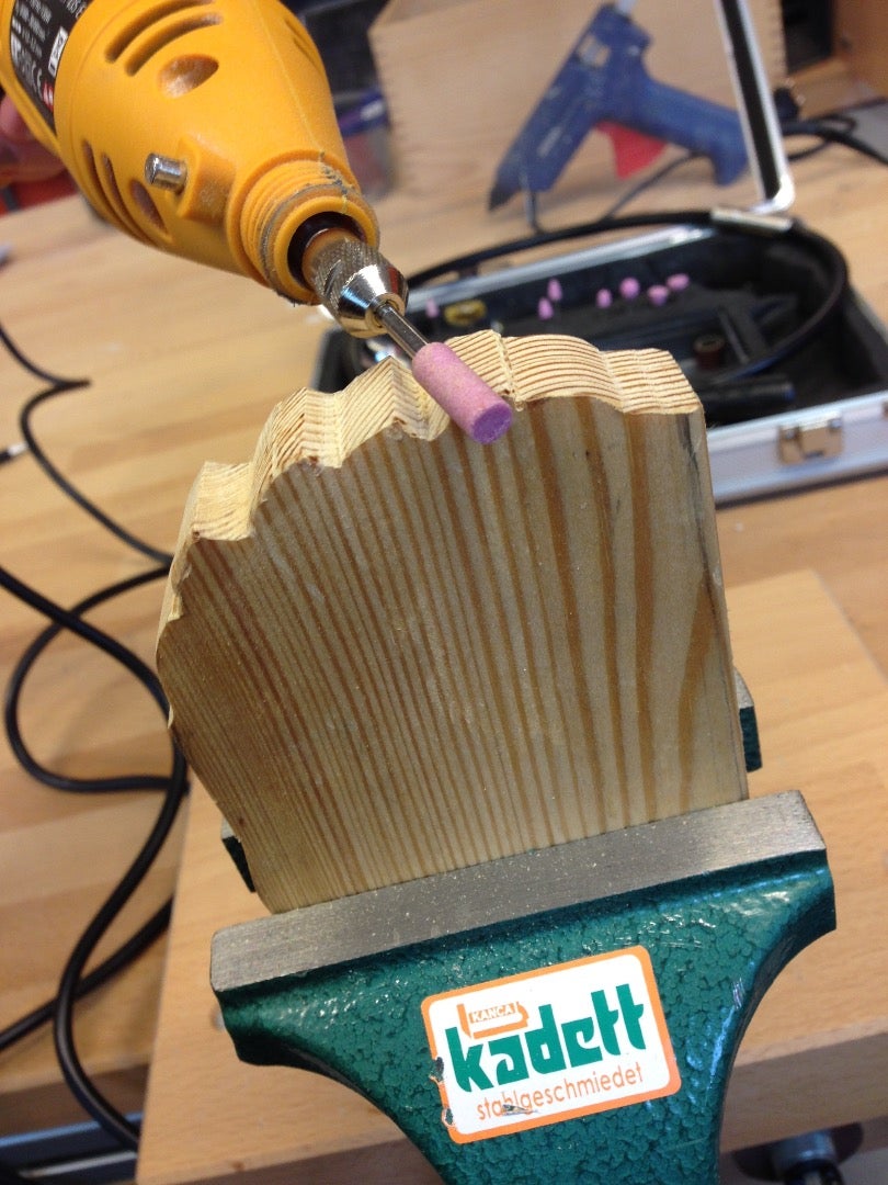

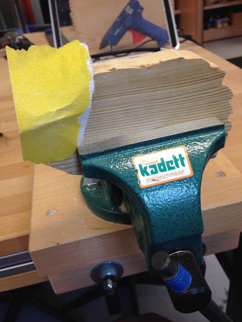

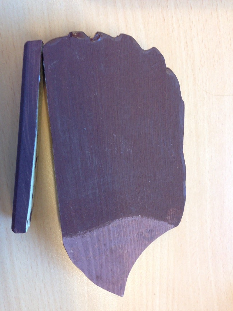

Step 4: Smoothen the Edges
For the next step I used the Polishing Tool to smoothen the small edges around the spikes of the hedgehog and to adjust smaller changes. For the bigger areas, like the bottom and the body of the toy, you should use normal sand paper because it is faster. You know that you are finished when the wood feels “smooth,” and has straight outlines.
Step 5: Paint the Hedgehog

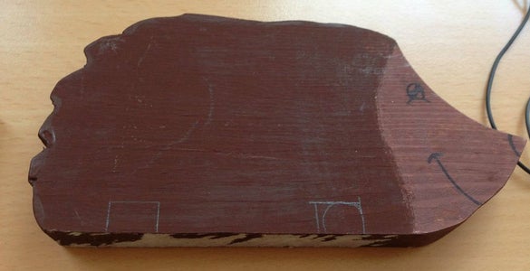

First, you need to draw an outline where you want to colour the toy. For example, the face, since it has a lighter brown colour than the rest of the body. For the body I just used a dark brown from the bottle. For the face I then mixed white with the brown colour to get a lighter tone. After that I drew the eyes, mouth, and nose on the face with a permanent marker because it is neater and easier than using paint.

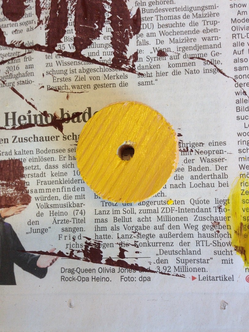

In the time the hedgehog dries you can go on and paint the wheels yellow (or any other colour that you want).

For this you have to draw little squares (big enough to fit the axles through) into the bottom of the hedgehog. For this be careful that the square is big enough, so the axles can move; but not too big, since then it might look weird if the wheels move back and forth at the bottom of the toy.
Once you have drawn the squares, cut them out with the machine again.

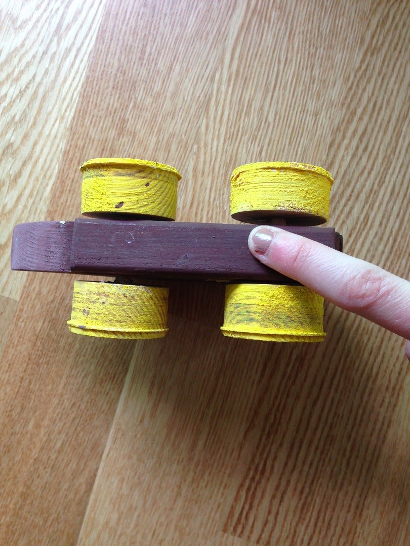

To secure the wheels on the axle, use a hot glue gun. Put some glue in the holes of the wheels, and then put the wooden stick through. The glue that might stick out in the end, can be pulled off when the glue is dry.
Do this for all of the four wheels.
Step 8: Put Everything Together
Once you have attached the wheels, turn the toy upside down, so the part with the squares for the axles are at the top. Put the axles in the holes, and then glue the additional wooden piece to the bottom.
Let it dry, and then you are finished!

Drying the Paint: If you painted the whole toy at once, then do not let it dry on newspaper because newspaper will stick to the paint and leave ugly marks at the bottom, which will then be more work than before.
