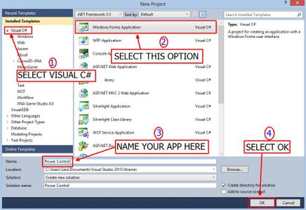

Step 1: Creating Your First Project
Now simply open visual studio and click on "new project" and then name it yourself. (i am naming it "power control")
The project must be a windows forms application with C# language selected in the left side menu !

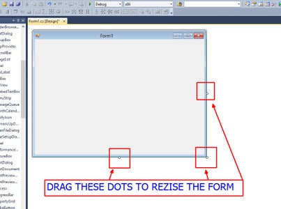

First you will see a windows styled small 300x300 form !
Resize it by the small dots around its corners.

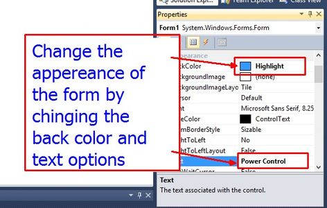

Step 3: Creating UI "User Interface" B
Now focus on the menu on the lower right size of the visual studio.
Change the settings there.

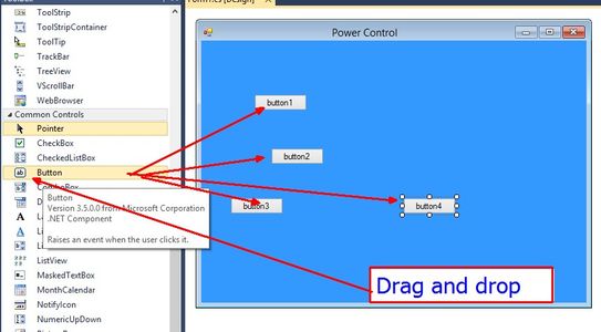

Now head to the tool box on the left side of the visual studio.

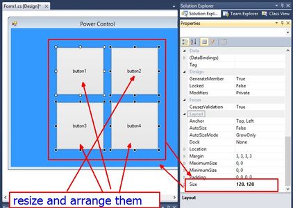

now add 4 buttons by "drag and drop" action.
Step 5: Creating UI "User Interface" D
Now resize the buttons by selecting all of them and change the size to 128x128 in the properties menu.

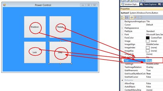

Now change the name of the button to
button 1 = shutdown
button 2 = restart
button 3 = lock
button 4 = sleep

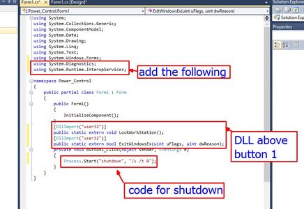

First double-click on the button 1 = shutdown (some codes will appear)
then write the following code
FOR BUTTON 1 = SHUTDOWN
Process.Start("shutdown", "/s /t 0");
FOR FUTURE USE ADD THESE ABOVE BUTTON 1
[DllImport("user32")] public static extern void LockWorkStation() [DllImport("user32")] public static extern bool ExitWindowsEx(uint uFlags, uint dwReason);
FOR ALL PROCESSES ADD THESE CODES IN THE SHOWN LOCATION ABOVE IN THE PICTURE
using System.Diagnostics; using System.Runtime.InteropServices;

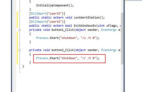

Now double-click the restart button and add these codes to it
Process.Start("shutdown","/r /t 0");

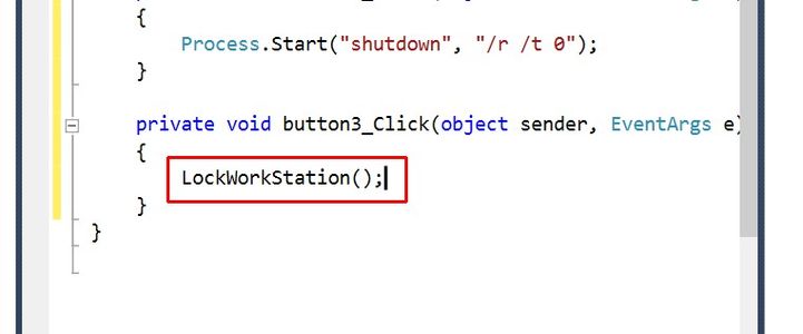

Now double click the lock button and add these codes
LockWorkStation();

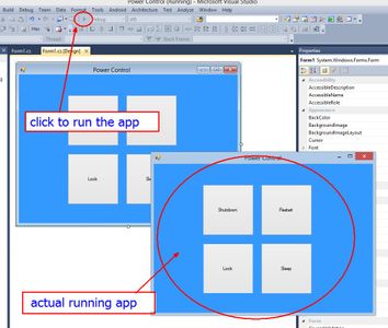

Now head back to your designer "Form 1" , and then debug/run the application !
Just try the lock button to test the codes are working ! or else if you try the restart or sleep button, you might lose your current work.
