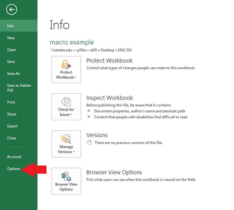

The first thing we must do is to get the Developer tab to appear so we can access VBA, the code language behind excel. To get started with this click on the File tab as in the picture above.
Step 2:
Once the file tab has been selected, the window will appear as above, now click on the options as shown in Picture 2.

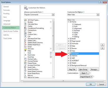

Once in the options window click on customize ribbon.
Step 4:
In the customize ribbon window select the check box by the Developer tab so that it appears as above in picture 4. After this click ok.

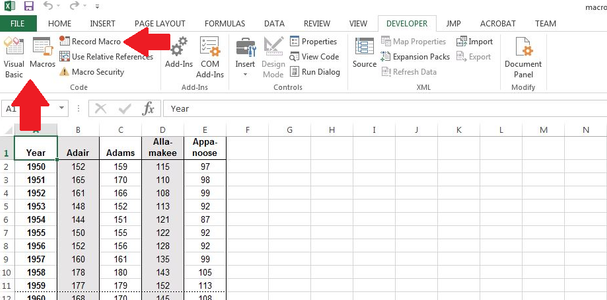

Now the DEVELOPER tab is on the ribbon as shown above. This tab will allow access to VBA through excel. Click on this tab.
Step 6:
Once in the developer tab, notice the Record Macro button next to the horizontal arrow. This is the main function we will be using today. Also the vertical arrow is pointing to the Visual Basic and Macros buttons. These will be used later to access the code for the macro once it has been recorded.
As I said before, today we will be averaging the four counties data and placing this value in column F, then graphing the year vs. the average. This is a very basic operation that many people may perform similar functions to, but macros can be recorded for nearly any operation you may perform in excel.
Click on the record macro button.

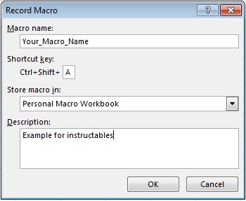

This box will pop up on the screen. The macro name will default to Macro1 (or whatever number of macro you are making). Macros have restrictions on their names, but mostly be sure to use an underscore (_) between words. The shortcut key can be specified as a keyboard shortcut not already used. Note that it will default to Ctrl + (your input), but if you use a capitol letter then it will look as above. Pressing all of the shortcut keys at once will automatically cause the macro to run, assuming that workbook is open. Next choose where to store the macro in one of the 3:
1. Personal Macro Workbook – you will be able to see this macro in all workbooks you open
2. New Workbook – This will save it to only a new workbook that will be generated
3. This Workbook – This will save it to only this workbook
Since this macro will likely be used on multiple different files, save it to Personal Macro Workbook. Lastly there is a description that can be added, but doesn’t have to be. This will be entered as comments in the code, which will be covered later. Once everything is entered, click Ok

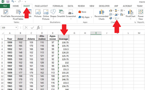

Start by averaging the first row. Then click the bottom right corner of the new cell and drag it down until the last row of the data.
Step 10:
The averaged column should look as it does now until the last row. Then click on the insert tab (far left arrow) and choose a chart from one of the drop down menus (far right arrow). For this example a scatter plot with straight lines was used. Hover over the different types for a description.

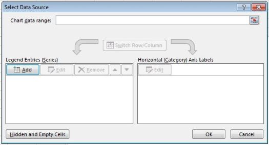

Once the graph appears blank on the page, right click in the graph area and choose select data as shown in the figure above.
Step 12:
This window will then appear, click Add so you can select which columns to graph.

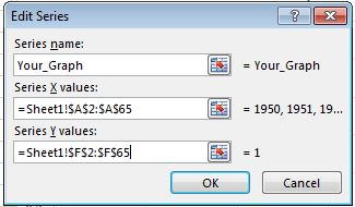

This box will then appear. The series name can be set as anything you choose. The x values in this case are the values in column A. The y values are the values in column F. An entire column can be chosen very quickly by clicking in the top column and selecting ctrl+shift+down arrow. Click Ok when finished.
