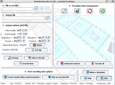

So (if you are at all like me) you have search-engined to no end for Zorg and Zflicks but have had no luck. Fret Not! There is an easier to use alternative, and it's name is PocketDivxEncoder. This is a general purpose encoder that will allow you to re-encode video to a variety of formats and sizes. The Default resoloution for a Zvue is 160 x 120. The process to converting a video to your Zvue is quite simple:
1.Choose the file to encode
2.Choose the directory to output the file to (NOT the Zvue, as it will take a lot longer!)
3.Choose video options (Quality, etc... Dimensions is where you can set the resolution to 160x120)
then just let click "Encode Now" and then kick back and wait for it to finish (it took about half an hour for Something Something Something Dark Side to encode). Then all you have to do is then drag and drop the video to the "Video" folder of your Zvue. Just make sure it has the room for it, and if you are needing to improve video quality or shrink the file (by decreasing Video/Audio quality).
