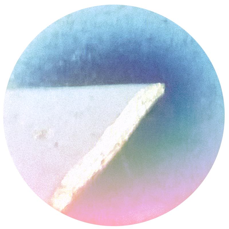

Once the glass had split in two, I ran several emery board strips against the inside and outside rim of both portions, removing the hazardously sharp edge of the bottle. Now I am left with two containers of which aren't effected by most chemicals, transparent, strong and above all, fascinating!
