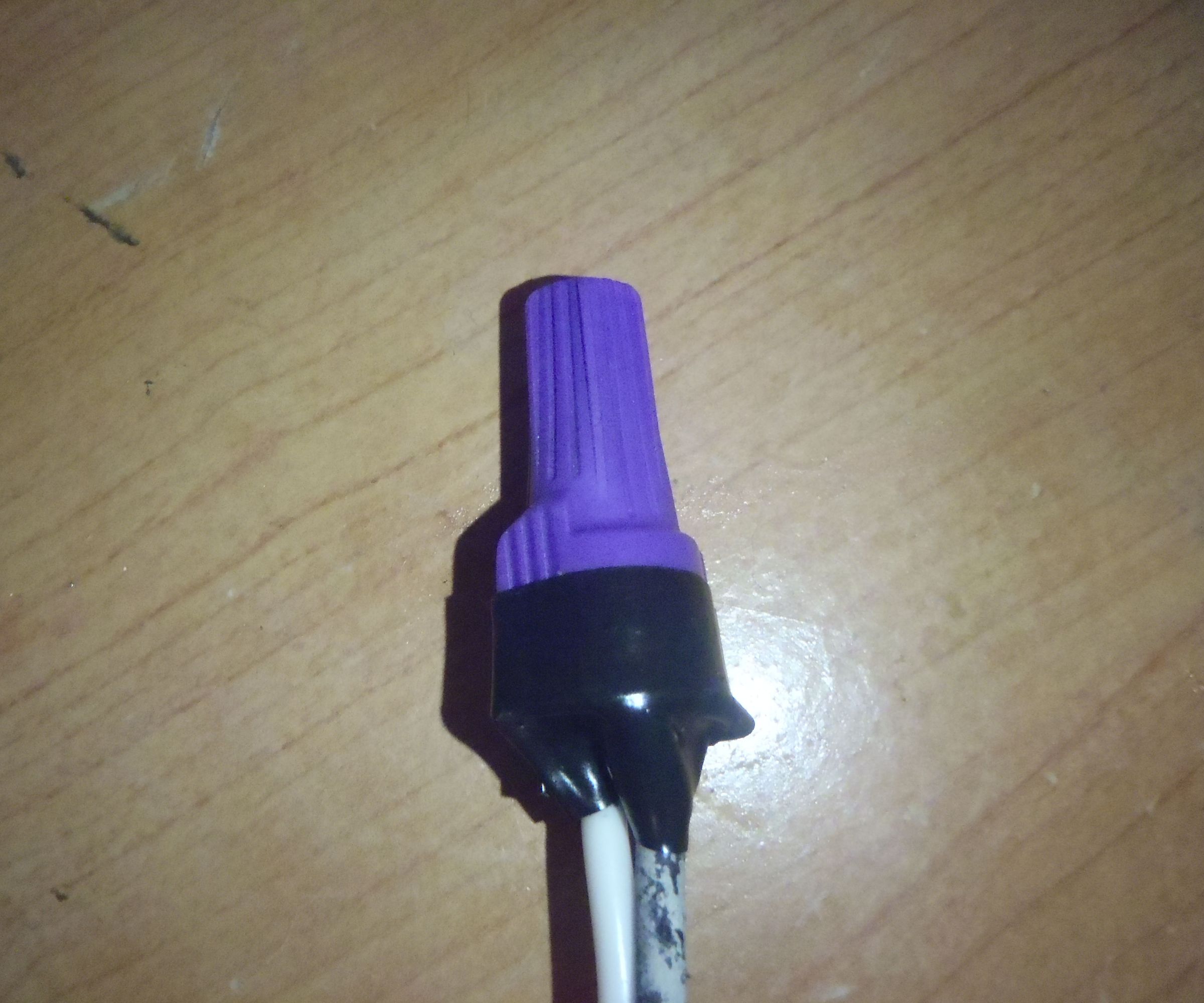

Step 4: Strip
Once you have nibbled the wire apart, pull of cut back the insulation the desired amount, and strip in the usual way using either the wire strippers, wire cutters, or the knife. I used a combination of all three.
Step 5: The Final Result
Here is what the wire looks like when it has been stripped. Thank you for reading!
