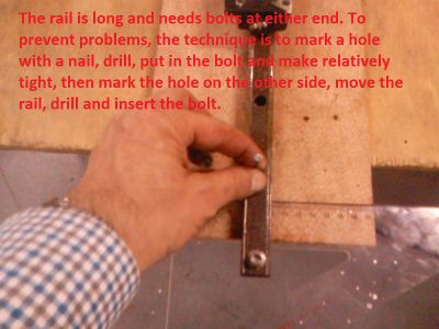

Step 27: Mark One Side of the Linear Guideway.
Time to mount the guideways to their wooden bases. Lining up holes, especially holes at a long distance is challenging for me. A good procedure to minimize wrongly placed holes, is to mark and drill a single side and bolt. Then, move the long part, in this case the guideway into the intended position then mark the second hole. Move the guideway away from the work area, then drill and put in position and bolt as required.
Step 28: Choose the Correct Bolt Diameter.
Again, the closer the match of the hole diameter with the bolt, the lower the probability for loosening over time. Remember, the heavy bag is throwing a lot of weight around and this jostling can loosen even the tightest bolts over time.

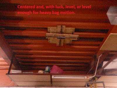

Step 33: Add Additional Bolts to the Linear Rail to Secure
Drill holes larger than the bolt diameter. Use bolts whereby the head will fit below the surface of the linear rail. Use washers, lock-washers, and nuts.
In the unlikely event that this was not done prior to ceiling installation, then perform the following steps.
Tie the cord of the power drill around the end of the extension cord so that it does not become disconnected while you are up in the ladder.
Put on the safety glasses because the sawdust will be coming down near your head.
After drilling four holes, where the nuts on the opposite side could be accessed, return to ground level to retrieve the bolts.
Take one screw in hand, and the allen key and wrench, then insert the washer, lock-washer, and nut into your mouth.
After climbing the ladder, place the tools upon the rig and push the bolt into place.
Next, using your tongue, slip the washer out of your mouth and place on the end of the bolt.
Next, do the same with the lock-washer.
Then the nut.
If the nut falls off the bolt when trying to thread, then press firmly into your figure to provide temporary adhesion, a you maneuver in place. Then tighten with allen key.
If the allen key fails to provide adequate grip for rotation, return to ground level and use a screwdriver style tool with the properly sized allen key insert.
Repeat for all four bolts, knowing that as you progress you learn and your technique improves, so that you do each one a little faster.
Note: If you do happen to leave a wrench or tool upon the apparatus after going down the ladder when done, no need to fret, because as soon as the new heavy bag begins motion, it will drop to the floor.

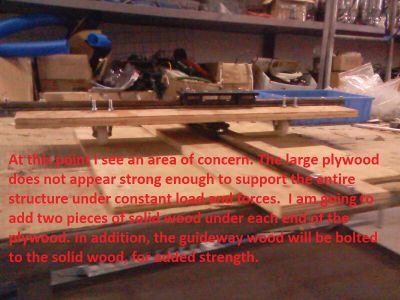

Step 34: A Potential Weakpoint Exposed
The large plywood may not be strong enough in the long run.
Step 35: Grab a Nearby Plank
A nearby plank will add the necessary structure strength. I do hate to use my good wood, as these handy pieces are like old friends that have put in their time on many prior jobs--but the heavy bag project is worthwhile, and I do not want to spend my cash.
Step 36: 24 Inch Cuts Leave Two Short Planks for Maximum Strength
Cut to length, 24 inches and a small end piece saved for a future project.

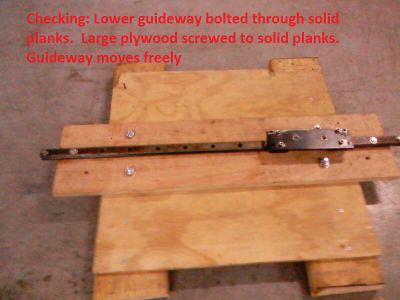

Step 37: Loosely Assemble and Confirm
Seeing is believing, for me.
Step 38: Measure So That Screw Heads Will Never Collide With Wheels
The large plywood is to be screwed to the base planks.
Step 39: Eight Long Screws Into the Solid Wood Plank
Screwdrivers are handy, but sometimes the electric drill is the best choice to get the job done fast and almost effortlessly.
Step 40: Mark and Drill Holes for Large Bolts
The hardware store bolts were long enough, and I did not pay close attention to the ramifications of the diameter. Luckily, the largest drill bit I had was a good size. And, as so large, it was not previously used so quite sharp--not so important for wood, but paramount for steel.
Step 41: Insert All Bolts, Then Tighten.
Always conscious of the risk of misalignment, four bolts are inserted. Note the head direction on three is opposite of the nut being turned by the wrench. This simple method allows a quick differentiation between completed, tightened bolts, and place-holder bolts. The place-holders were dropped down at the time of drilling from the top down, so bottom up was not an option as it would require moving the apparatus.
Step 42: Toss It on the Floor and Take a Gander
Confirm adequate mounting. Any more fasteners required?

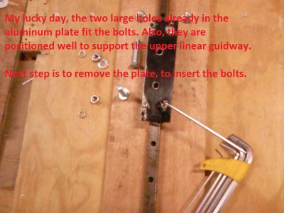

Step 43: Begin Process to Mount Upper Guideway Assembly to Lower Guideway
Typically hex bolts are used on industrial linear guideways. As production and use is international in nature, the bolts utilized may be metric or English. In this case, the metric hex wrench is used to loosen the hex bolts.
Step 44: Use Drilled Holes in Aluminum Plate As Template
Saving measuring, simply oriented the aluminum plate to the proper side (see the pre-existing holes offset, thus creating a proper side demand). Centered for alignment.
Step 45: Used the Sharpee to Mark the Entire Circle
Mark all of the exposed wood, to ensure proper hole drilling.
Step 46: Insert Bolts
Insert bolts with head side under the aluminum plate. The bearing block height exceeds the bolt head height so no clearance issues. Add lock-washers to the smaller bolts connecting the aluminum plate to the bearing blocks.

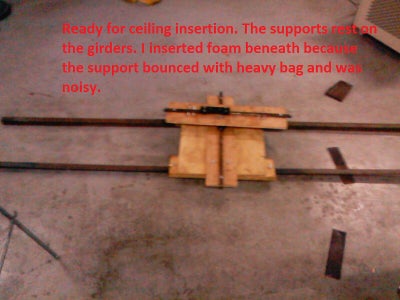

Step 57: Place Supports on the Motion Structure to Align and Mark
Rather than trust measurements, especially when dealing with a bunch of old parts with their own idiosyncrasies, it is better to physically align and check then mark.
Step 58: Time for the Big Hammer Assistance
Step 59: Toss It on the Floor and Get Ready for Ceiling Installation
Step 60: Use Whatever Is Available to Make Your Installation Safe
A table is sturdier than a ladder, but unfortunately shorter. So, use each as needed.

Step 62: Take a Breath and Ponder the Install--satisfied?
Step 63: Aligned, Centered, Level?--Satisfied.
Make your criteria for your satisfaction. Know yourself and your requirements and resource availability to arrive the satisfactory balance for your heavy bag.
