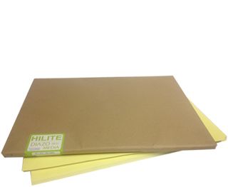

Step 6: Diazo Paper
You will need some blueprint diazo paper. I found mine on ebay for six dollars.

12 years ago on Introduction
where can I get diazo paper to buy? So far no one seems to know what I am talking about.
