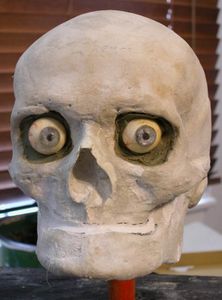

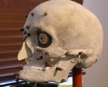

Step 4: Setting the Eyeballs
Eyeballs are then created and set into place in their anatomically accurate position (they are usually positioned at an angle to produce a lifelike effect). Most adult human eyes are about the same size (26mm). This is the eerie part when the skull begins to seem alive!

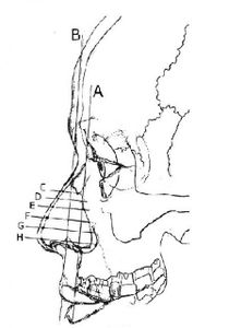

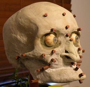

Step 5: Estimation of the Nose
This next step has been well studied and documented; there is less guesswork than one would assume. The nose tends to follow very clear guidelines as to the shape and angles of the nose. There are a lot of nose shapes and there is a long list of articles dedicated to this one aspect of the face!
Step 6: Adding the Nasal Cartilage
In this step a piece of styrene is used to form the "backbone" of the nasal cartilage. The depth markers are also in place but I will explain those in the next step.

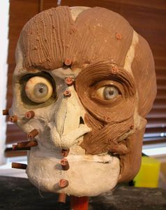

Step 7: Finishing the Nasal Cartilage and Adding Depth Markers
Here the nasal cartilage (the stiff portion of the tip of the nose) is sculpted in and the depth markers are placed at osteometric (specific, measurable points) on the skull. Here again there is extensive literature on the depth of the soft facial tissue at these points; it is based on the age, ancestry and health of the individual.

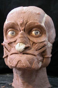

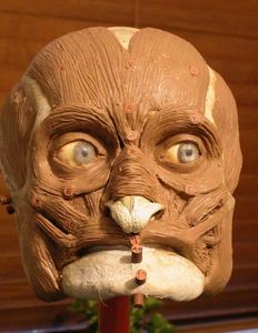

Step 8: Adding the Muscles of the Face
Here the individual facial muscles are sculpted in. The placement and thickness of the muscles are determined by the skull morphology (shape) and the tissue depth markers.
Step 9: Muscles Continued
Here the muscles of the upper face are almost complete
Step 10: Muscles Finished and Neck Added
Here the muscles of the face and the neck are pretty much done. also, glandular and fatty tissue are added.

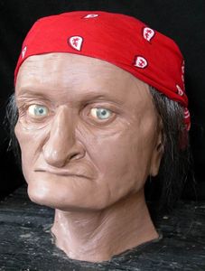

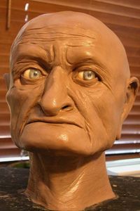

Step 11: Adding the Skin and Ears
In this step the skin layer is added. All the wrinkles and pores are added according to anatomical studies and the estimated age, health and habits of the decedent (such as smoking, alcohol and drug abuse, and sun exposure).

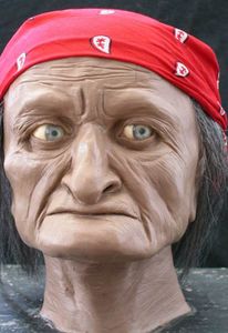

Step 12: Adding Hair
At this final step any hair, accessories or clothing that were found with the body are added. Photos are taken, often in Black and White so that no information that we do not know for certain is conveyed to the public (such as eye, hair or skin color). And hopefully someone recognizes the individual so that an identification can be made. Please vote for this project in the Up contest here! Thanks.
One final note, this case did end in an identification, but I cannot add any details of the case or pictures of the individual for obvious reasons, so please don't ask.
