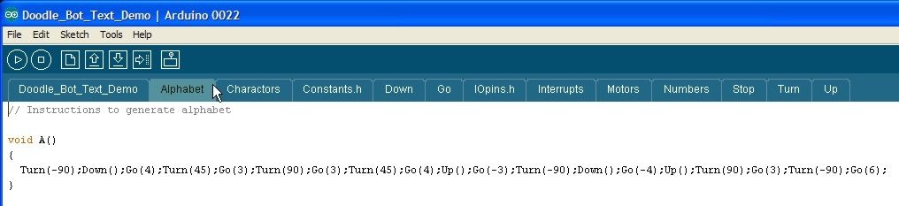

To create new characters, fonts or symbols for Doodle Bot to draw you must first draw them on a grid. This will give you a map to work with and help you ensure all characters are the same size. As you can see in the first picture, all the numbers and letters included in the sample code were first drawn in a grid.
The instructions for each character assume that the robot is starting in the bottom left corner of the grid facing to the right. When you create a new character you must make sure you include instructions that leave the robot in this position ready to write the next character.
If you look here at the code for the letter “A” and compare it to the character map above you will see that after drawing the letter the robot raises the pen, goes to the bottom of the character and then goes right 6 steps.
It only had to go right 4 steps to finish in the lower right corner of the character but it went an additional 2 steps to create a gap between the letter A it had just drawn and the next character to be drawn.
