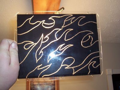

Step 2: Tape Off What You Don't Want Painted.
Tape off what you don't want painted.
I had holes on my window for mounting that I did not want to get paint into.
Step 3: Spray Paint
Spray the side of the Plexiglas that is engraved. Use a spray paint that will stick to Plexiglas. Don't use latex paint
Step 4: Rengrave the Plexiglas
Now rengrave the Plexiglas going over what was already engraved. This is also time to add any detail to the window.
Step 5: Put It Back in Your Case.
Put it back in your case. Enjoy the glowing engraving.
