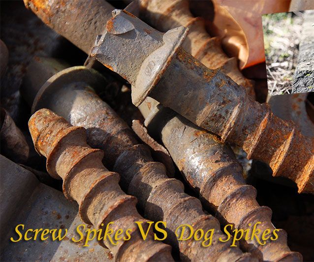

The railroad spikes play an important role in ensuring the safety of the railway transportation. In order to make more use of the railroad spike, it is very strict for the workers to ensure the pull-out force of each screw spike more than 60KN ( 6 tons ). Here are the mainly processes of fastening and maintenance of railroad spikes.
