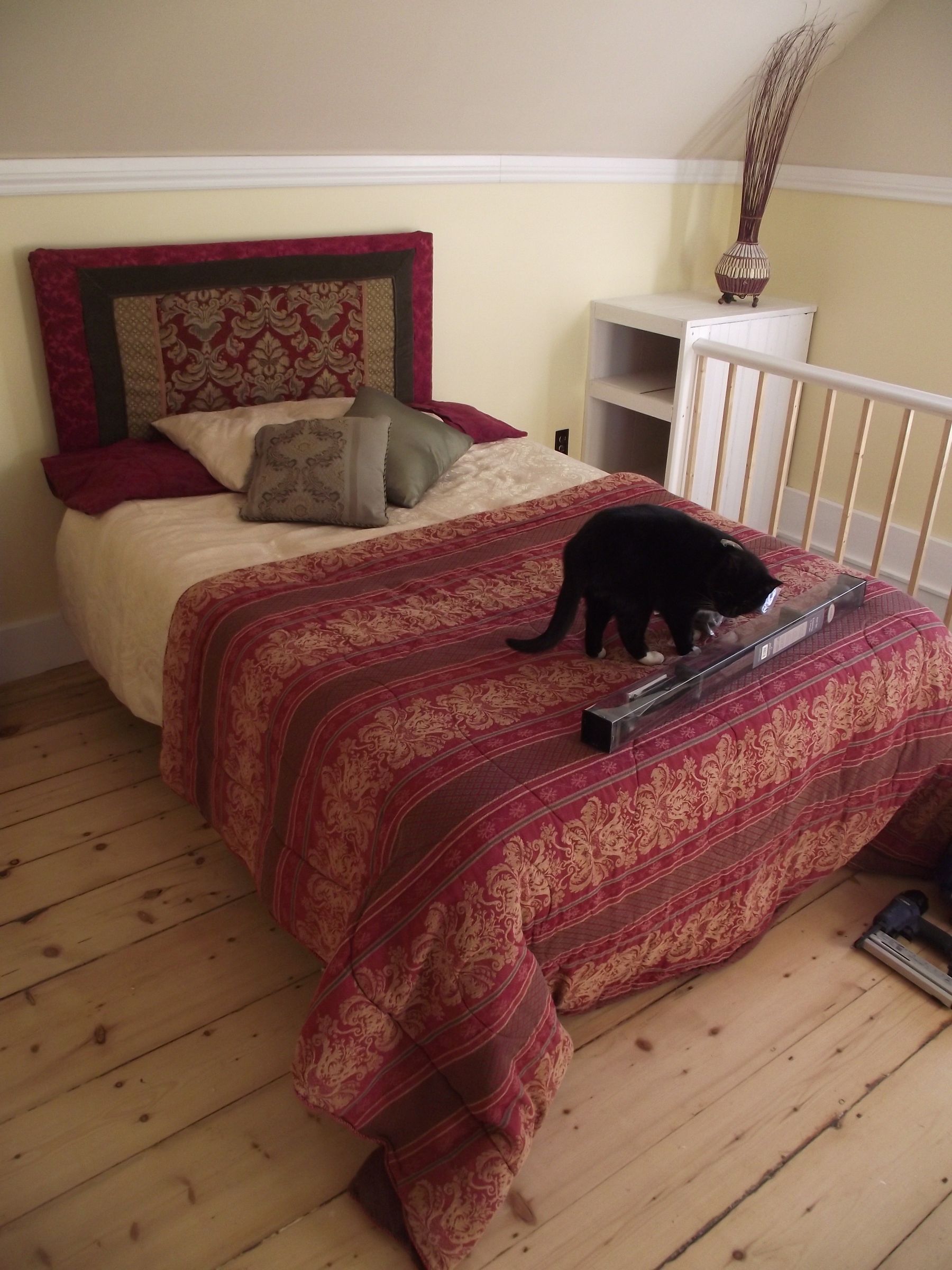

We've got an older home which we're renovating - it's over 120 years old. More modern houses have flatter walls, but as we're not rebuilding the house that's not an option. Even with the modern gyprock (plasterboard) we've found the walls have a slightly wavy quality. Adding moulding to the wall and we're finding gaps between the wall and the moulding. There are also a few holes in the ceiling where the plaster has been damaged.

We've put up the moulding already - nailed using brad nails and a compressor, and glued in place too. But as you can see from the moulding, where the ceiling isn't flat, and it's been damaged, there's a hole to fill will drywall compound. We wanted a very plain crown moulding so we're just using some 3" by 1" pine which we can then prime and paint when we're ready to go.
