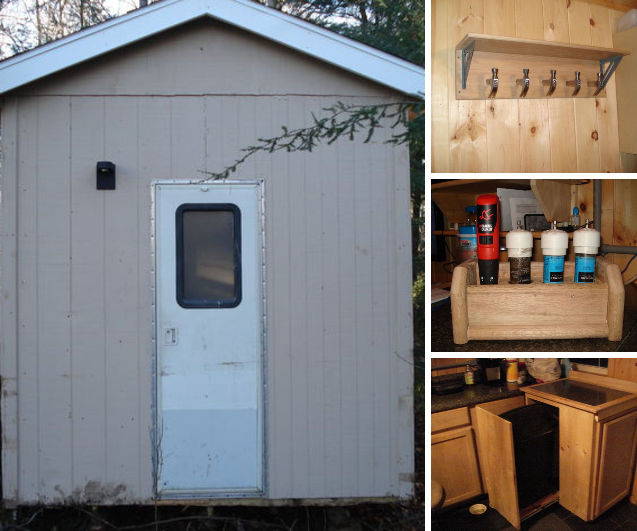

Step 19: Finished Inside
here the the finished inside pictures. The futon we had . The the two night stands and tv stand  i made a long time ago. So a little by little i will fill it up...
