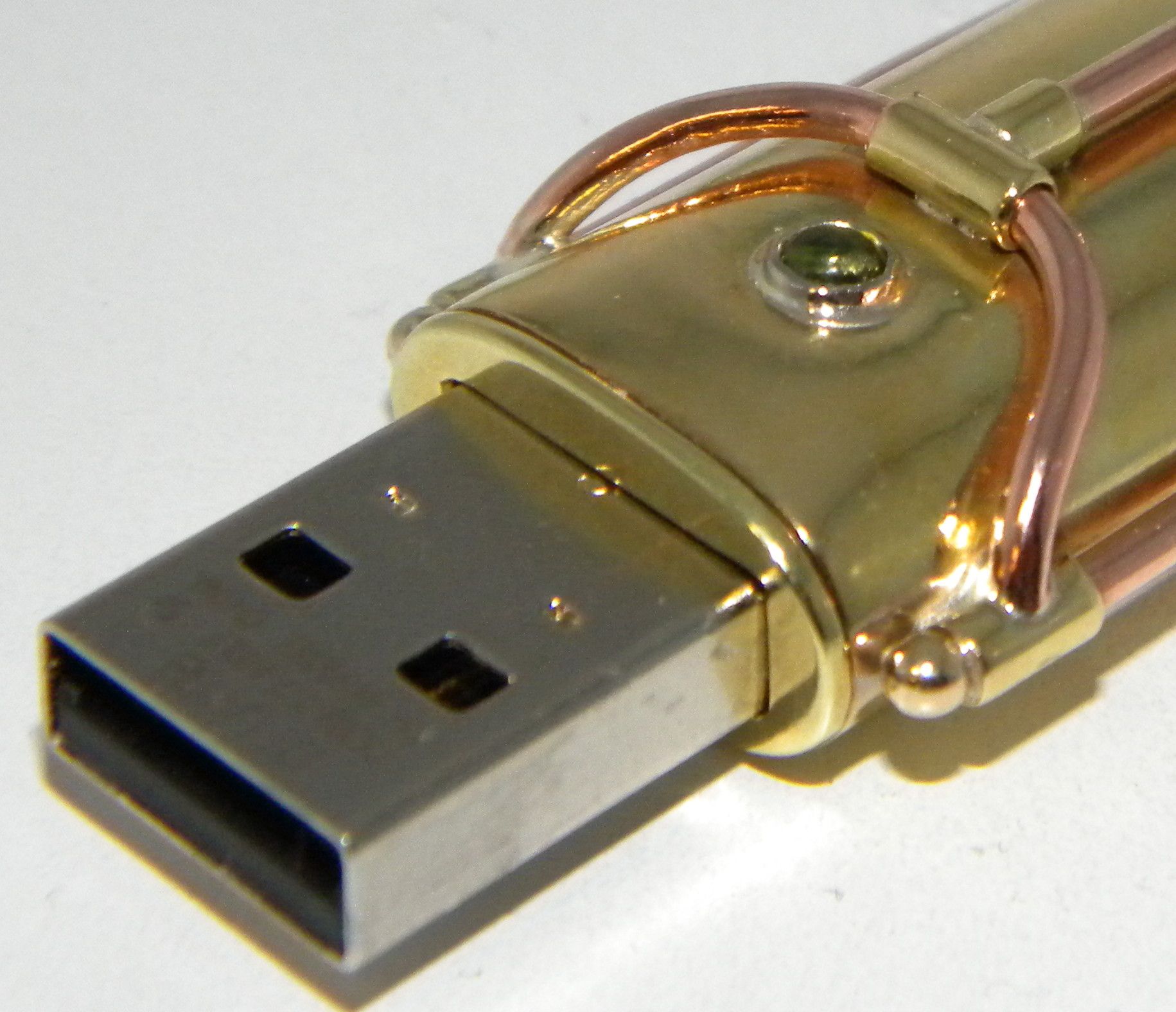

This is how to flush set stones for jewelry or other similar items. I will show where to use this in other instructables. A sleek way of setting stones without adding components to the item as well to hold that stone.
