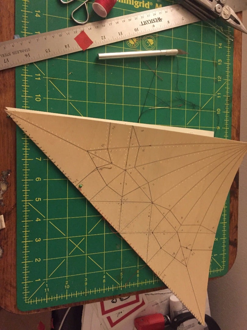

Securely tape your cardstock (I taped two layers, just in case) to a sheet of cardboard. Carefully align your paper above this. Using a thumbtack/pushpin, make a hole at every line intersection. As careful as I tried to be, I ended up missing some, but you can easily realign your template to substrate with two other pins. Using your substrate as a guide, carefully trace the crease diagram on the cardstock. If you notice from the other crease diagram, I've added a couple things, such as a full diagonal through the wings, as well as a full square in the middle. Since wood doesn't have the same flexibility as paper (and once I move away from cardstock, it will have very little flexibility) I wanted to ensure that it could still make the three-dimensional shape in the center.

So how do you 'fold' wood? Particularly, how do you fold wood in a way that it will be able to burn away completely in an Effigy? Instead of creasing it, you cut apart each fold, and sew it back together. In order to do this, I punched holes roughly 5mm apart over every crease-line on the wood. I did it in a zig-zag pattern, but for the 3-foot and 16-foot versions, I will place the holes side-by-side across the crease, in a way that allows me to lace up the fold like a shoe.

Use a ruler and Xacto to cut only a single line segment at a time (i.e. not the full diagonal, but only the part sewn in pics 2 & 3). This way nothing is ever detached. Thread the line through the first hole until only a little bit remained on one side, and hot glue it. In order to make sure a 'crease' had flexibility, I sewed around a small glass rod, though later I switched to a chopstick, which I liked better. Wind the thread through, being careful not to snag or tangle it, a feat that becomes exponentially more difficult as the project goes on. At the end of the line segment, tighten everything with a pair of tweezers, then add a dab of hot glue on the other side.
