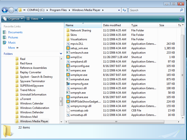

Click the start menu
click COMPUTER or MY COMPUTER
select your harddrive
Click Program Files
Click WINDOWS MEDIA PLAYER
When it opens, locate the wmplayer.exe file

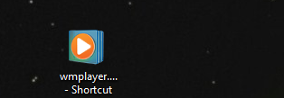

Right click it and create a desktop shortcut

Now that you have a wmplayer.exe shortcut on your desktop, right click it

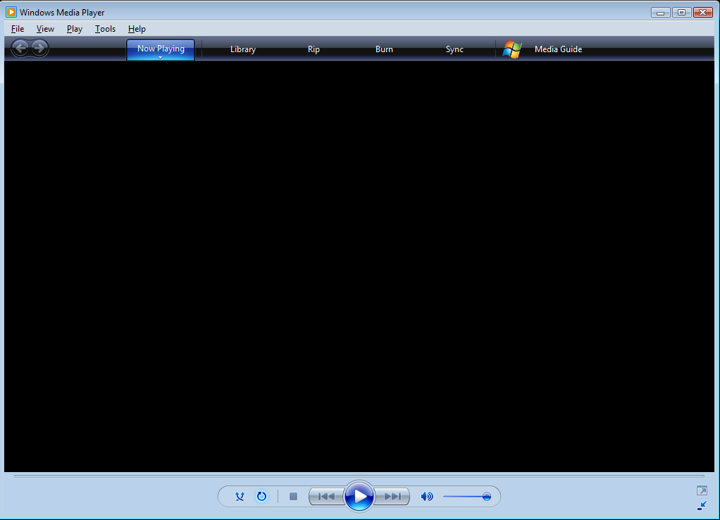

Click the shortcut and watch it open in the correct window.
