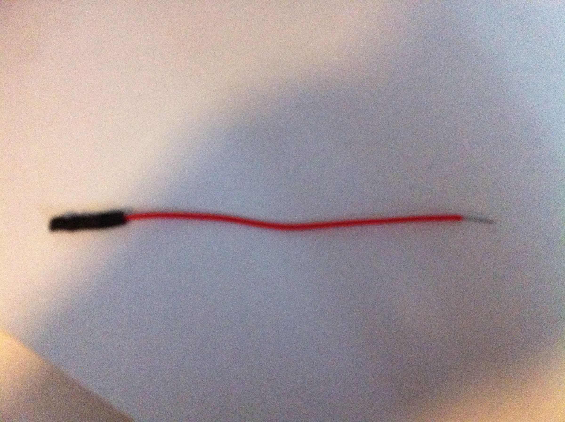

Step 1: Connect the Led to Pin 4
Just connect cathode lead to Ground, and anode lead to pin 4 of the microcontroller like this:
