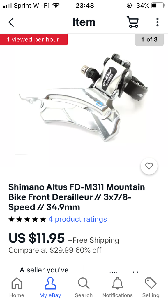

Update: I found this inexpensive Shimano Altus dual pull bottom swing front mech to work well with this small front gearing. I installed the front mech with a rubber shim and gently bent it with a long wrench by leveraging inside the cage with no chain on, rotating the cage counter clockwise as seen from the drive side (photo of red bike included).
This makes the cage able to swing close as possible to the front freewheel, majorly improving shifts and lowering the cable travel needed to derail the chain over the gears.
