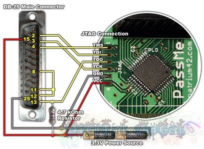

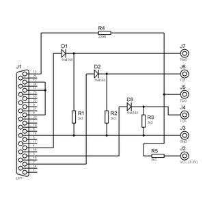

Step 5: Coolrunner LPT Program Cable
you can just go buy a cable to program your coolrunner for you or if your really going to go all out with DIY then heres how to make your own. the second image is a different one if the first one didn't work for you.
you'll need
male LPT port
4.8 kohm resistor
if the first cable didn't work then you'll need
male LPT port
220 omh resister (x1)
3.3 komh ressister (x3)
1N4148 diode (x3)

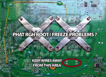

Step 7: Install/solder the Mod Chip In
now come the fun part! you get to solder the cool-runner into the actual 360. if you can't solder small points now would be the time to get someone else to do this for you. the first picture is a complete over view and the ones after that are of my personal install.
the wires of the coolrunner are pre-tinned and cut to the perfect length for optimum glitch time (how long it takes to boot up). i would suggest just putting small amounts of flux on the wires and the motherboard, then touching the wire down and applying the soldering iron until the solder on the wire melts into place.

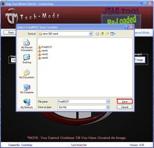

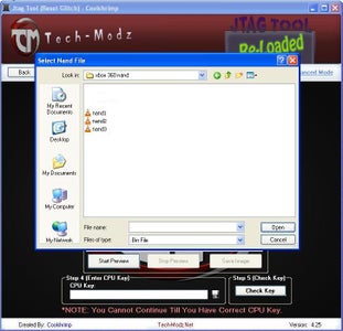

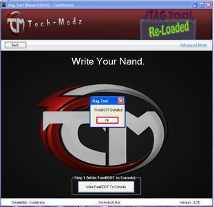

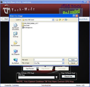

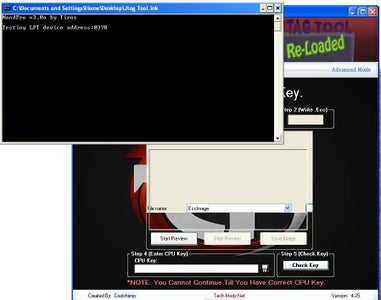

Step 8: Write the Nand

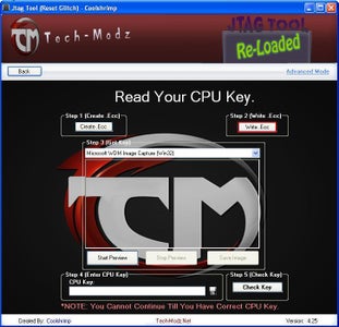

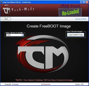

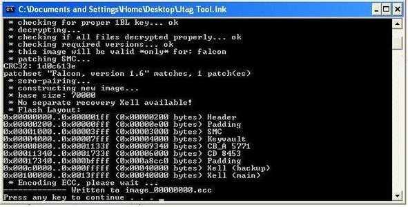

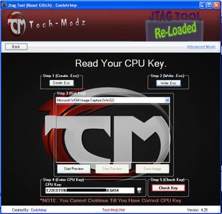

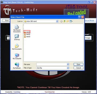

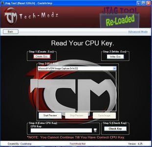

remember those nand dumps we made at the beginning? well now it is time to use them to make something called freeboot. to make the freeboot file you need the cpu key from your xbox so open up jtag tool and follow the images.

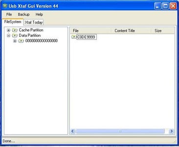

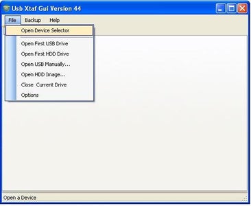

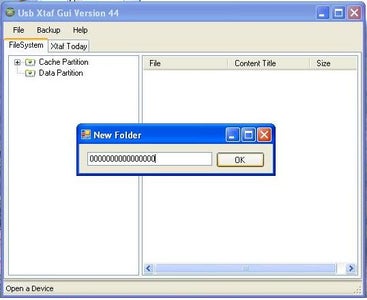

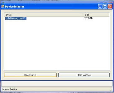

Step 9: Installing Xexmenu

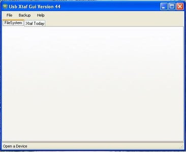

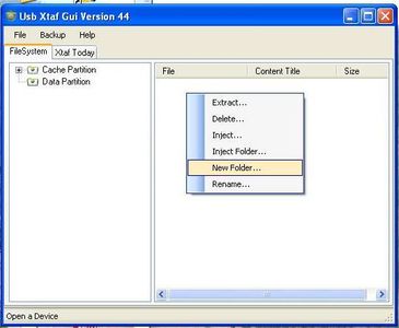

ok so now that you have freeboot installed you can start up your xbox and if it boots then everything is good so you can unsolder the nand cable and pack up your xbox back in the case and put it where it would normally go, everything will be done with usb from now on. you need to get a usb stick and format it with the xbox. download the program i have uploaded and go HERE for the files for xex menu. open up the program you downloaded and follow the images.
