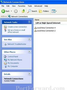

Step 2: Setting Up Your Static IP Address
To do this your going to need to open control panel(Start, control panel...) and find and double-click "Network Connections". Now there may be a few connections in here and were going to need to change the one you use to access the internet. If you don't know which one it is, right click on one and hit disable then refresh your web browser. If nothing happens re-enable it by right clicking and hitting "enable" then keep doing this to all the connections in there until when you refresh it says can't connect/the web page doesn't show. Once you've found out the right connection your going to have to right click it and click "properties".
Once your in this window look under the "this connection uses the following items:" and right click "internet protocol" and yet again select "properties". A window should pop up. But before you change anything jot down the current information shown just incase things get screwed up.I want you to click "Use the following IP address".
