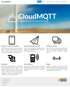

Step 2: Preparing Broker Server - CloudMQTT
1. Visit the http://www.cloudmqtt.com/
2. Sign up with your e-mail and login.
3. Create CloudMQTT Instance.
4. Complete.
