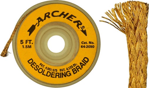

Step 2: Des-solder the Flashlight Less and Resistor
It was a very repetitive job, but someone has to make it... I wish I have had my helping device for this job but actually I was made it.... :)
It wasn't dificult, just using the desoldering braid and the tip of the solder for every single led.... 54 times :/
