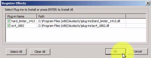

Step 6: Install Additional Plug-ins
Click OK to install addition plug-ins needed by Audacity
