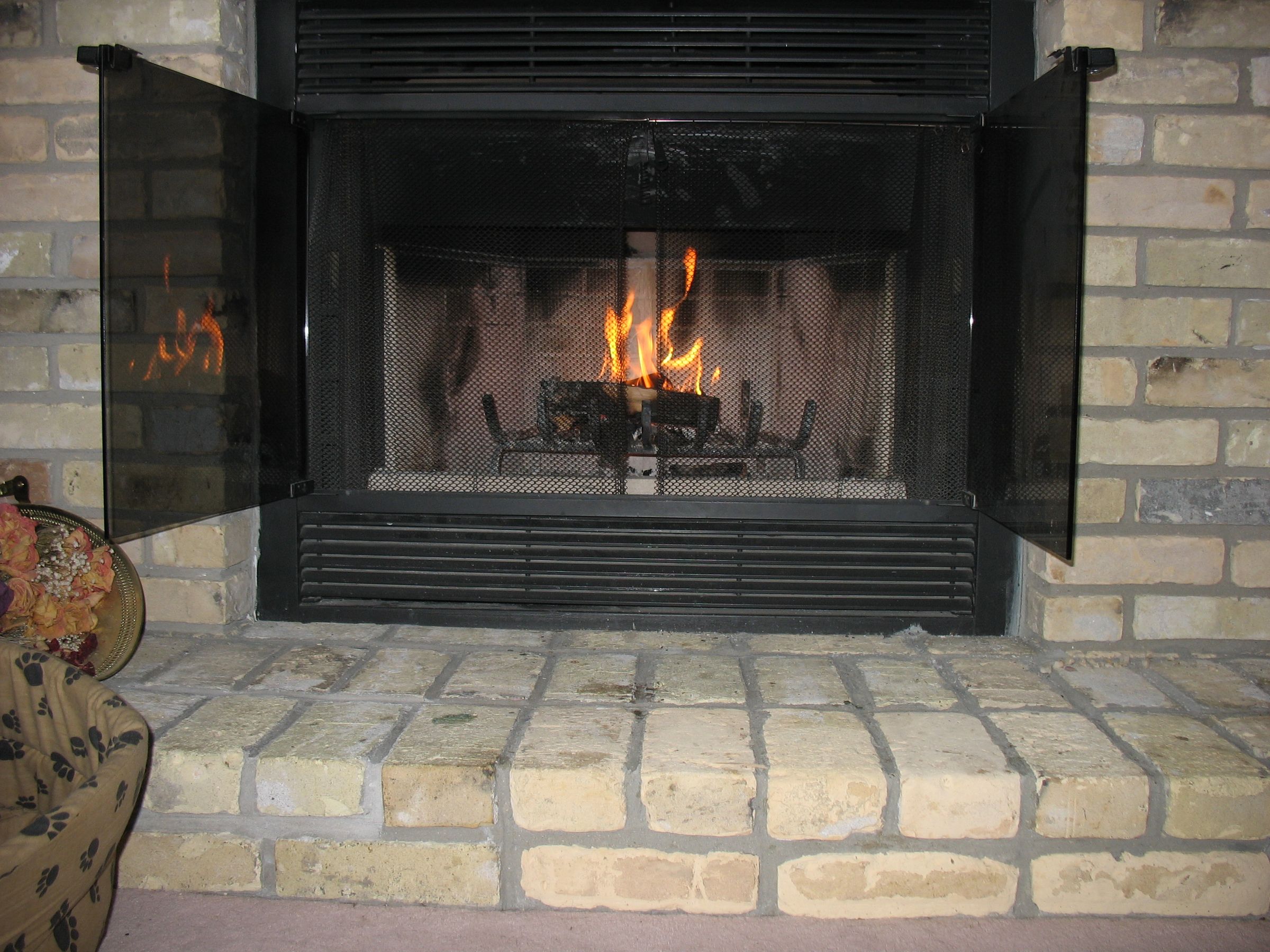

As a told you earlier this tool is worth the rental cost. Not only can it speed up the cutting of the laminate, but it is very exact you can nip off a quarter of an inch easily to get the perfect fit. The other benefit is that the cutter does not kick up dust like a conventional saw would. Unless you have curved edges (like I did around the fireplace) this tool will do it all, otherwise you will need a jigsaw to cut curves.
