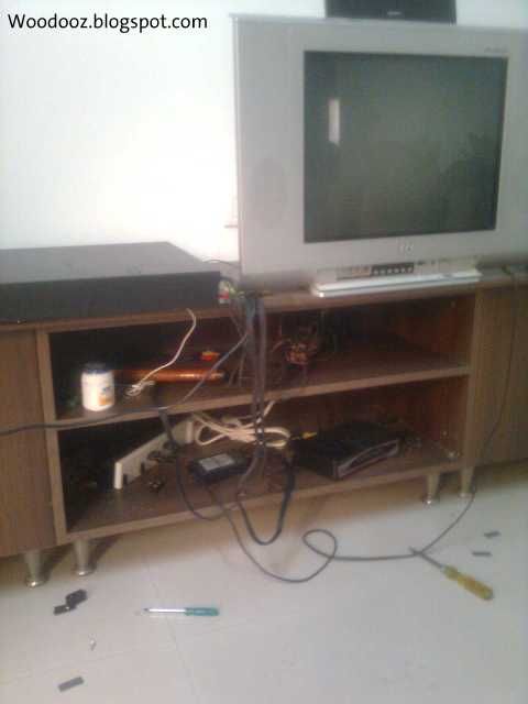

Step 1: Identify Cabinet Needing a Door
Identify the cabinet needing a door
Our TV stand turned Shoe Rack badly needed a door and was the obvious choice for this exercise. The rack is in the living room, and going by the contents in the cabinet, you can pretty much understand why this needed to be covered.
Measure the sides of the cabinet before buying the plywood for the door
