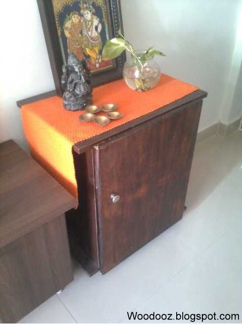

Identify the cabinet requiring a glass door
In this case, it is the centre cabinet of our TV floor unit
Difficulty level: Medium to high
Time required : 1-4 hours depending on expertise
Tangible benefits: A better looking cabinet with all the clutter being hidden, cost saved on transport and installation charges
In-tangible benefits: The sense of satisfaction that any DIY can give you
Step 0: Objective – Install a glass door
