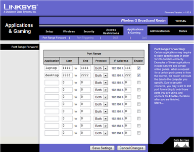

In your web browser, type in the Default Gateway IP from the previous step. It may ask for a password, it may not. It should be different for everybody, for me it's admin/admin - The default Linksys password. If that doesn't work, i suggest checking Google or a manual.
Once logged in, look for port forwarding. Enter in the IP address from the previous step, and a random port number. I wouldn't suggest port 21 or 80, as they are FTP and HTTP protocols default ports. You don't want random people being able to access this, so random numbers that only you know are the best. Make sure the protocol is set to both UDP and TCP.
This will be different for everybody, unless you have a WRT54G. You'll just have to search your settings for these.

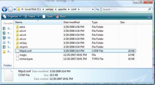

You'll want to copy this. Now, go to your xampp installation directory, go to apache, then go to conf.
Open httpd.conf in notepad, and find "Listen 80", (Without quotes) And add another line below that, saying Listen followed by the port number you chose in step 2.
Next, look for "DocumentRoot" (Without quotes). Delete what's in the quotes, then paste your location in them. You'll need to change any slashes to back slashes (\ should be changed to /)
Lastly, look for "<Directory "C:/xampp/htdocs">", substitute your install directory for c:/xampp
It should be around line 204. Replace what's in the quotes with your directory, once again, switching the slashes.
Now save the file.

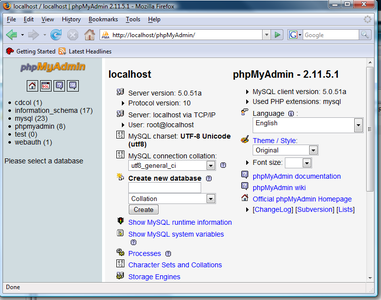

You can use php, and mysql in any file that you put in the web root folder.
