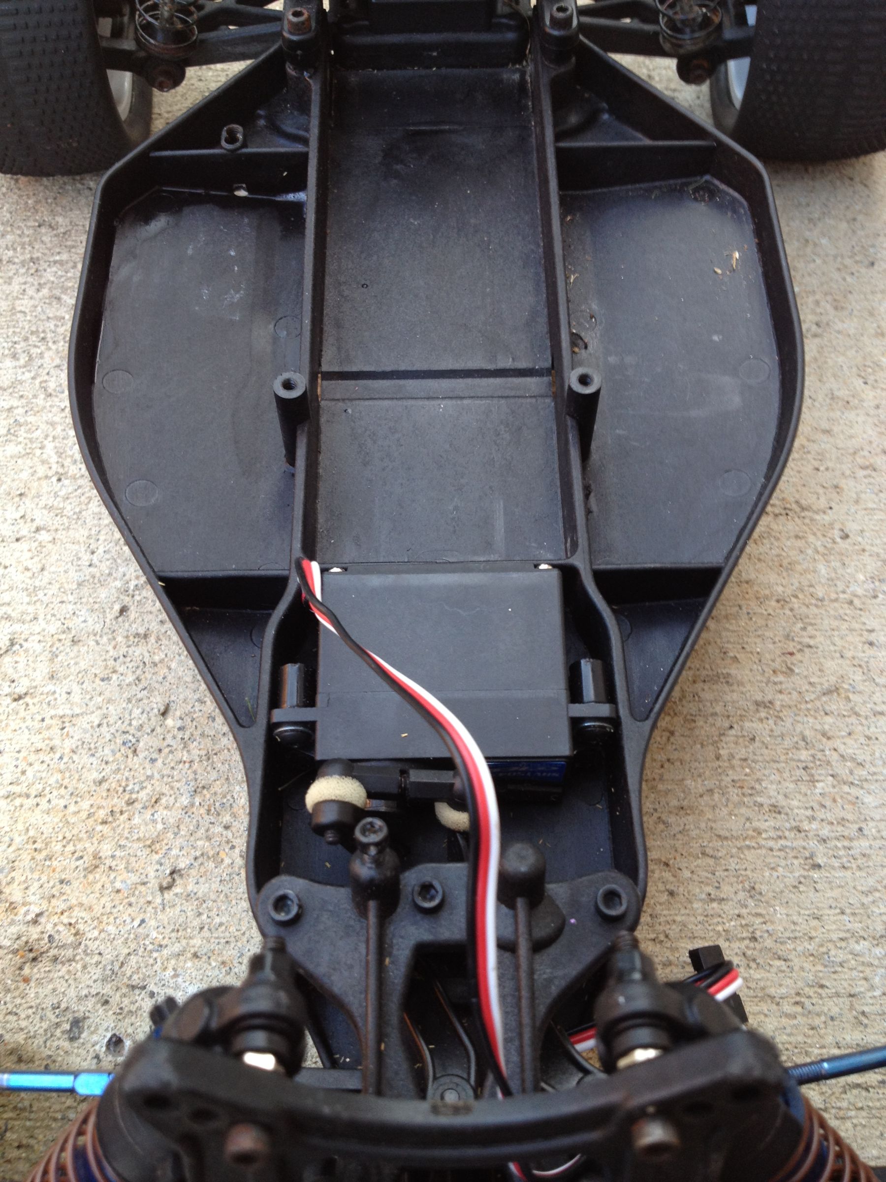

So, there are many ways to get a RC car without electronics like used, or buying one without, etc. I will show you how to install electronics in a rc car. The exact model I am using is a Team Associated RC10B4.1 Electric Model, but the installation will be next to the same on most rc buggies.

A assortment of small hex drivers.
RC car preinstalled with servo
motor
speed controller prefitted with plugs
battery
RC controller
radio transmitter
motor
battery
RC controller
radio transmitter
