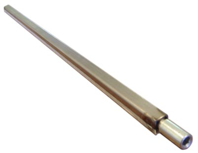

Step 2: Before You Begin....
before you being to intonate your guitar, fix any problems you have with string action, neck adjustment, etc. I won't explain how to adjust the action or truss rod adjustment in this Instructable, but if you don't know how to do either, recommend you don't try to.
Adjusting string height or neck curvature post intonation can put you back to square one, so i recommend you do so before you begin.
If possible, put on a fresh pair of strings on beforehand.
