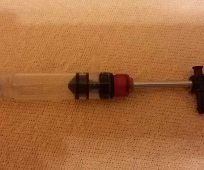

Next drill one big and one small hole. The small one is for cable. The big one should be close to the outer bore of the metal pipe. Then use drill, knife and sandpaper to give the wood shape as in the picture.
Step 6:
From some sort of round hard plastic piece make light-bulb socket by drilling a hole just big so the upper body of a light-bulb can go through . Cut and attache with glue two metal pieces for connectors to the plastic piece and solder cables to the connectors . The light-bulb that I used was for car dashboards. It fits good and can be changed if needed from the bottom of the gear shift knob. You can see in the picture the cable going through the smaller hole and exiting in the bottom. In the picture is also a light-bulb similar to one that I used.
