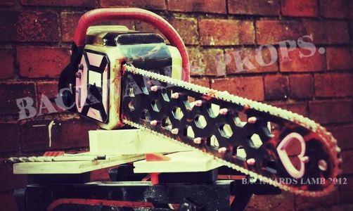

Step 5: Step 4 : Blade Construction.
i used the plans i made to get the blade.
the plans were used to cut out three layers of the blade at 3mm thick each.
the reason behind this is so that the middle layer had pegs on to hold the bike chain.
the placement of the pegs depends on the size of the bike chain you have, i measured it and tested it a few times to make sure they fit, also make sure to print it out and test it over the curve at the end of the blade as the pegs will be different after the curve, i didnt do this so i had to make the middle layer twice to get the chain to fit.
this part could also be made from thin wood, dint in the same way. if the wood is too thick to fit inside the chain you dont have to have pegs but you will have to make sure you use strong glue.
i glued all the layers together then drilled a series of 5mm holes and cut the m5 bar to 20mm lengths to go in the holes with dome nuts on either side. not only does this look good but it also makes the blade a little stronger.

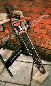

Step 7: Step 6: Paint
spray the body of the chain saw and the removable side plate and the blade all black. and then wait for them to fully dry.
then using reference photos mask of the areas that will be gold on the main body and pink on the blade and side panels.
spray the bod gold. wait for it to dry and remove the tape, then re tape just exposing the areas that will be pink.
spray the blade body and side panels pink.
also paint the dome nuts pink.
once everything is dry remove the tape.

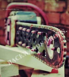

Step 10: Step 9 : Blade Detail.
Bolt the pink dome nuts through the holes in the blind.
When you have put all the bolts through place half the first half of the bike chain over the pegs and use epoxy glue to secure them on while they are setting use tape to hold it in place.. Once dry wrap the chain round the tip of the blade and onto the lower pegs and glue it all down with epoxy and tape until set..
Then the blade is done.

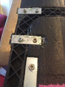

Step 12: Step 11 : Fixing the Blade.
when every thing is dry its time to drill the blade and make it secure.
place the blade inside the cavity you have made then put in the L brackets up from the base and make sure that they will attach to the lower part of the handle.
Drill through the side panel (make sure the holes will be covered by the side panel.) and make sure they line up and go through the L brackets once these holes are drilled these will be what makes the blade secure.
Step 13: Step 12 : Securing All the Parts.
use L brackets to attach the body to the handle and blade etc.
put them where ever you can get a nut and bolt through..
once you have secured the parts together use some epoxy resin to fill in gaps. i poured a lot of the glue into the cavity where the blade is inserted into the body.
also drill into the body through the L brackets and put some epoxy glue in there and put some bolts in to secure it more.
more fixing places are always better.

when all the glue has dried its time to weather and get bloody.
acrylic paint is used to weather the body of the saw,
dry brush some silver paint onto the high points and corners of the saw. this will give it a worn look, then over dry brush some light and dark browns to make it look dirty and rusty.
this is also a great way to cover up any imperfections that may have been missed. on mine there was damage sustained to the top of the body under the top handle so i added some rust to it. (makes it look like you meant to do it.)
once all the weathering has dried get some very bright Red paints and paint some bloody splashes and stains.
this is all done to taste, i went with a weathered look as the handle i got was a used item so was scuffed so it wouldn't right to have a clean new body and a used handle so i scuffed up the body.
once all is dry use a matte lacquer to seal the whole lot, this makes it a little more hard wearing.
then you are free to kill zombies in your cheer leading outfits! :)
